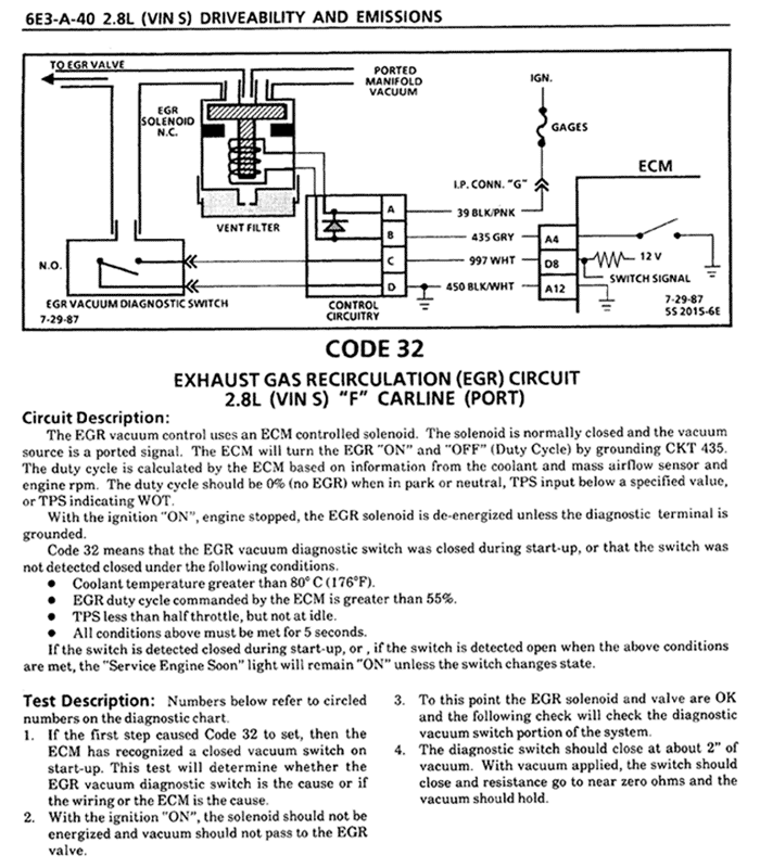

code 32, getting frustrated
well i had replaced the egr valve, i bought it used, could it be that the used one i bought is not working properly? , i replaced it and disconnected the battery to clear the code, now two days after i get it again, only happens sometimes in the highway, its starting to frustrate me, is my computer just freaking out? my car has no problems whatsoever, like my uncle saids(mechanic) if the car doesnt give you ****, dont worry about it

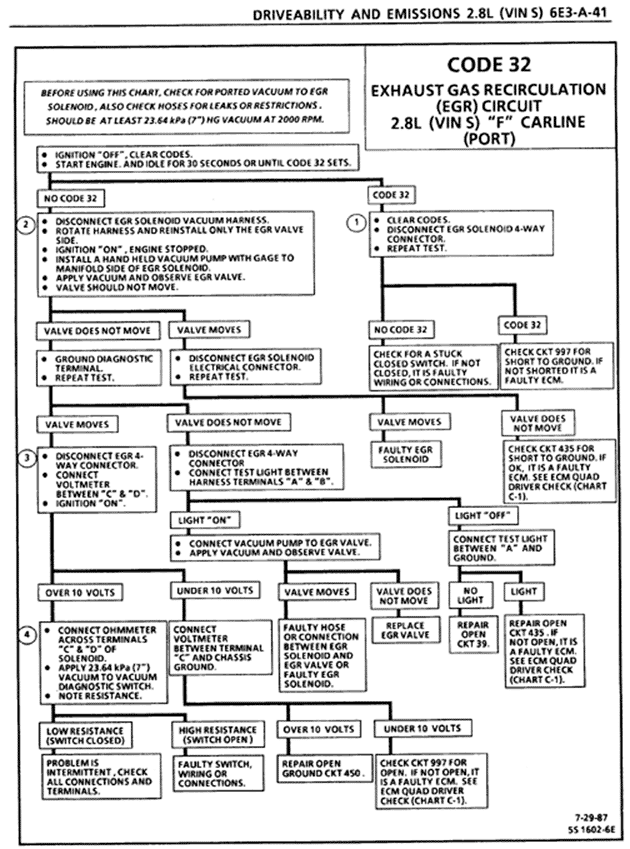

Did you check the EGR solenoid and the vacuum lines? I know this chart is for a 2.8L, but a lot of the basics are the same.

page 2

your da man trickster, now i just need to find some stupid mechanic to do this for me, i figure if the ones i went to didnt know how to do this they shouldnt be a frigging mechanic. thanks alot, im printing this out, gona go see who will be the lucky one to do this for me
btw where did you get this at?

I got it out of the GM service manual for my car.
