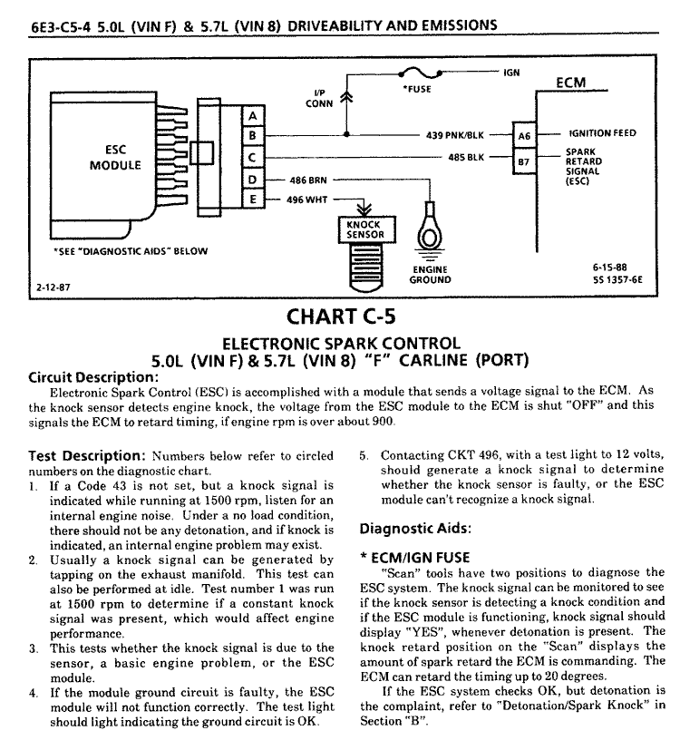

Have I sent you these yet?

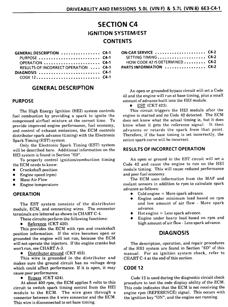

page 2

No, thou hath not!
Thanks! I've been meaning to ask you for that one.
