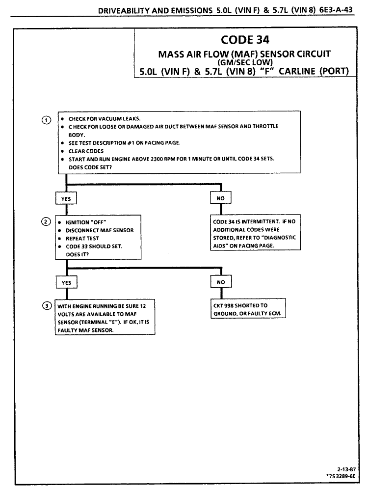

No, it is not possible for a mid-year addition to take place. The only way for your car to have a LB9 engine with MAP is for someone to convert it to MAP afterwards. Here is a picture of the MAF as it should be on your car along with a chart for trouble code 34. BTW, are you getting your codes from a haynes or chilton manual?

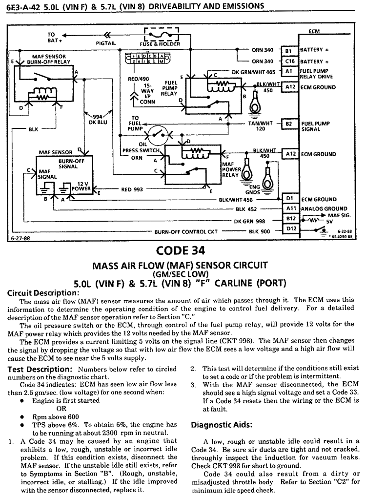

page 2

page 3

Thank you very much. I will attend to this problem as time permits. Hopefully I will get this thing going!!
