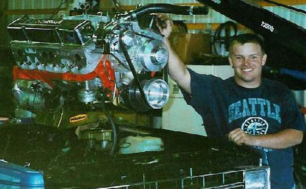

The age old question..
"So you want to go fast? How deep are your pockets???"
Start building a 350-400, ditch the 305
Heres my old S-10
