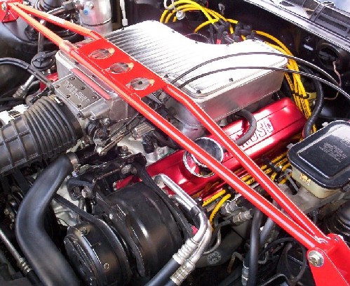

What you can do is get your hands on a set of Felpro 1255 intake gaskets.
If the ports on the heads match up with the 1255 gasket you are in good luck.
The SDPC Base can be ported to match the 1255 nicely, but not a whole bunch further beyond it.
Did you sell the miniram?
I got a ported Superram with SDPC base I might be willing to trade you or sell, oh yeah it is already ported out like a ****.

I have the SDPC High Flow Vortec base on my 88' TPI 388cid with Alum fastburn heads.

Re: Re: fastburn???
I'm I mistaken or is the radiator hose in this image collasped? Why?

lol..yeah, do tell?
email me and let me know what your asking...i've been looking at quite a few setups. i plan to pick one up monday. i sold the miniram though as i had it up for sale here for almost 3 weeks now.
rgarcia63, please do tell more....i want to know how much work it will be to get the thing to fit properly.
