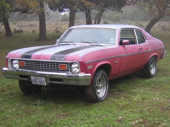

P.S. Here is the Nova the TPI is going into.
