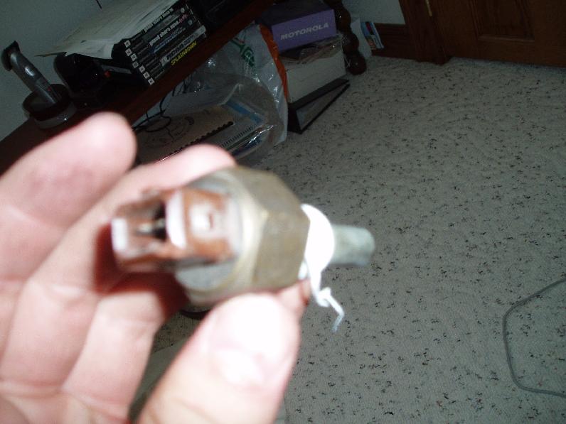

alright ladies and gentleman...round two...we got a sensor from the front of the intake, its the bigger one of the two that taps into the intake...I think its the coolant temp sensor...but check out the pics...there was another sensor just like it that tapped vertically into the driver side of the intake, but it was a bit smaller, and I got that to fit...but this one is too small for the 1/2" hole on the new HSR intake...what should I do??

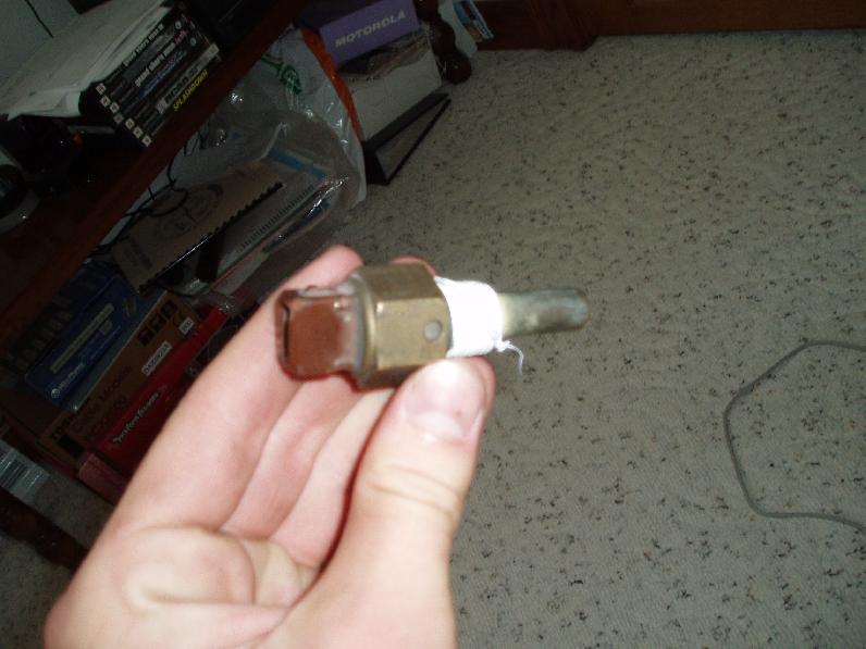

another...

Old Jun 9, 2005 | 05:08 PM
rsn932's Avatar
Joined: Mar 2004
Posts: 420
thats the cold start injector switch. it tells the ecm when to put in extra fuel on startup via the CSI. however, since you now have a stealthram, you no longer have a cold start injector. get a plug for the hole in the intake.
Old Jun 9, 2005 | 05:13 PM
klumb15's Avatar
Joined: Jun 2004
Posts: 1,663
From: Menominee MI
okay..its the hole thats right behind the altenator on the pass. side right? i just want to make sure....then i can put that 1/2" plug back in there...
Old Jun 9, 2005 | 05:25 PM
rsn932's Avatar
Joined: Mar 2004
Posts: 420
yup. the only sensor you need in your intake is the CTS for the ECM.
