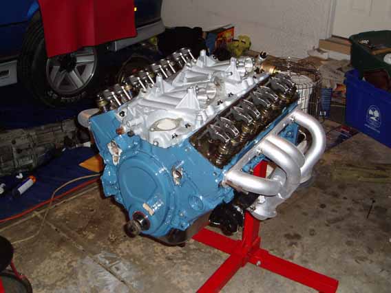

well, I think my MPH due mostly to my ported TPI in combination with my headers and cut out. It seems that my little 305 pulls alot harder in the uper rpms. I just look at it like this.... how are those runners gonna produce much more power if they arnt the restriction. If the holes at the base end are smaller that the runners the base isnt going to magically flow more air.if you do some searches on SLP runners i think you will come to the general concensus that if left un touched along with an un touched intake, It will yield almost no power and perhaps make you slower due to turbulence. Porting doesnt have to take a million years either... I split up my work into several days in 2 hr increments. it took probably 4 hrs for the base another 4 hours on the runners and another 4 hrs on the plenum. Its not too bad if you are patient and dont need to drive your car. here are some pics of my stuff. how could this not be infinatly better than stock?
