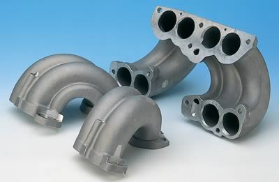

Hi, I was just wondering which aftermarket tpi runners flowed the best. I have seen the slp, edlebrocks, and the accel. I just wanted to know, I will still use the factory upper plenum, and have the factory base ported. I just need to know since the engine is around 366 or so cubes. Thought I'd ask. Thank you

Between the Edelbrocks and the SLP runners, everything I have read says the Edelbrocks flow more out of the box.
I'm not sure about the Accel ones.
If I were going to buy aftermarket runners (and I am soon ), I would spend a little extra and get Long Tube Runners (LTR) from Arizona Speed & Marine or TPIS. They are supposed to provide alot more torque & HP while retaining a stock appearance.

EDELBROCK HANDS DOWN

You have a website for these runners, I am getting a 88 Trans am on saturday. It still has a factory intake, only things not stock are the heads and internals. The engine was claimed to be high 280's with a stock tpi, so I want to find something that flows better...lol. BTW, anyone interested in a 91-2 Camaro Z28, hardtop, at, 5.7L???? Just saw it today, no idea on price...lol. Thanks again guys.

This will give you an idea of a few runners performance
https://www.thirdgen.org/techbb2/sho...hreadid=273727
There are some flow #s for the accel here.
http://stealthram.com/flowcomparison.html
Here are the dimensions of some of the runners im sure the larger diameter ones flow more unported.
Stock TPI-------- 7.250"------1.470" round(1.70 sq inches)
SLP -------------- 6.625"------1.600" round (2.01 sq inches)
Accel LTR------- 6.625"------1.615" round (2.05 sq inches)
TPiS-------------- 7.625"------1.660" round (2.168 sq inches)
From everything I have seen the TPIS and ASM runners flow the best unported but the SLPs are capable of being extensively ported.

These are the accel ltrs and are around the $400 through summitracing.
Ok TPIS runners will run you $475
http://www.tpis.com/

Prowling around Dyno Don's shop I get to see the different intakes. Out of the box the Edelbrock units are the best.
I recently saw a set of Accels that will have a big time air leak. To much machining was done and the supplied gaskets would not seal up the gap. They will either be sent back or welded up. Quality control was absent.
Out of the box I'm not overly impressed with the SLP units. However if you are going to modify or work on the runners than that is where the SLP's shine and are the best. They have a lot of meat and lend them selves to be modified to your hearts content.

OK, so if I am going to eventually extrude hone the runners, I should get the slp's? Do those look nice once you polish them?

Dollar for Dollar, SLP's. They can be ported to all hell. Paired with k&ns, gutted boxes and runners, it makes your intake sound gooood.

AZS&M - highest quality out of the box - no contest TPIS = same thing for more $$

SLP sucks . Well stock they do . They are cisually smaller than the edlebrock ports. It's a shame though that the Edlebrock ones are so dam pricey . Check my site I got a pic of mine siamesed in 4" . They have LOTS of room for porting
Old Jan 28, 2006 | 01:24 AM
Dave Farr's Avatar
Joined: Feb 2005
Posts: 142
I didn't want to spend hours grinding, one rule of thumb is keep the same manufacturer for the base and runners. Since I have the Edelbrock Vortec base- I went with the runners and just ground the casting marks- all pretty pricey- keep in mind to have a couple spare sets of lower gaskets- Edelbrocks are different from GM. I learned the hard way- tighten the lower runner bolts first.

I had to grind the AZS&M runners slightly arround the bottom flanges to fit the vortec base.

I love my AS&M runners. They are already extrude honed from the factory. Thats why there is a 1-2 month wait for them.

I have SLP runners on an Edelbrock base. the SLP runner ports line up pretty good with the manifold base even though they are different mfr.
I'm not so sure it's worthwhile to get aftermarket runners if you're keeping the stock base. the stock base is pretty restrictive, and not a whole lot of meat for grinding.
The SLP runners don't have any advertising on them. I'm happy with them.
