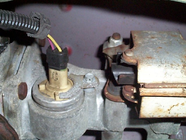

That looks like a standard 2 tower weatherpack connector. I'm fairly certain it will look like the one in this pic...

I'm guessing you're right about the connector. I've never tried to match one up, but it's likely a plain, old two-wire WeatherPack.

the VSS connector that I have here is not the same as a regular 2 prong weatherpack connector.
The Reverse light switch is the standard type but the VSS is a different one.

Anyone know if they changed the VSS connectors in different years? My original VSS had that standard two-tower weatherpack connector as shown by Vader, but my new VSS has the connector like Zepher's.
So I have a harness with the two-tower connector and a VSS with the other style. Would you happen to have that connector in stock 92blue (if so, PM me)? If not, I can just jam the harness connector into the VSS and use some dielectric grease and electrical tape. It does fit, it just doesn't fit like it should, obviously.

I am fairly certain that the pic posted by Vader is the 2 tower weatherpack connector. I have seen it used for VSS on TBI truck harnesses before. GM does have the habit of reusing connectors throughout their different vehicles.
fire350TPI, the connector you will need will depend on the VSS you buy. The one in the pic I posted is a 4000 pulse, which goes with Zepher's picture. I believe your 87 used a 2000 pulse VSS (someone correct me if I'm wrong, perhaps it used a 4000 pulse and a buffer box to bring the signal down to 2000?). If thats the case, I think its going to be the weatherpack connector.
