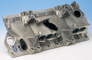

Here's a picture of both Edelbrock's and Acell's intake base (rumour has it Edelbrock now supply TPIS with their base aswell and they just hog it out a bit and raise the price accordingly)
but anyways, the older TPIS units said "TPIS" right on them in the same spot you see "Edelbrock" and "Acell" written on their intake. It's should be in plain view.

Here's an article on TPI systems. If you scroll down, you can see a picture of TPIS's "big mouth" base plate and it says "TPIS" right on it like I said. If that's what you have, keep it, as it's the best base you can buy.

The TPIS intake says "big mouth" where the edelbrock unit says "hi flo". They are all made by edelbrock and have the same casting #. 3860 or 3680 or something like that. Its cast on the bottom of the intake at the front china wall rail.

Obviously the easiest way to tell if you have an aftermarket base would be the lack of a "GM" with the casting# next to it. Also, all gm intakes have the firing order cast into them whereas most aftermarket ones don't.
