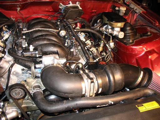

btw the front tires in the pic where my rears lol one thing thats nice about the C-4 brakes can use 4 rear rims

Also I was looking at the original posters pictures and I am just curious to what extent that LO-3 exhaust system hurts TPI's performance ... Or has it been changed? Also his injectors kind of look like grey top vette multec's is this true too? .... Also curious internally speaking if he has had cam/head swaps? Or is this a bone stock LO-3 .... My TBI combination seems to run pretty strong, but can't really compare mine to his.
Gotta say though he kinda inspired me to drop my polished TPI stuff on my engine and really detail my engine compartment LOL.
