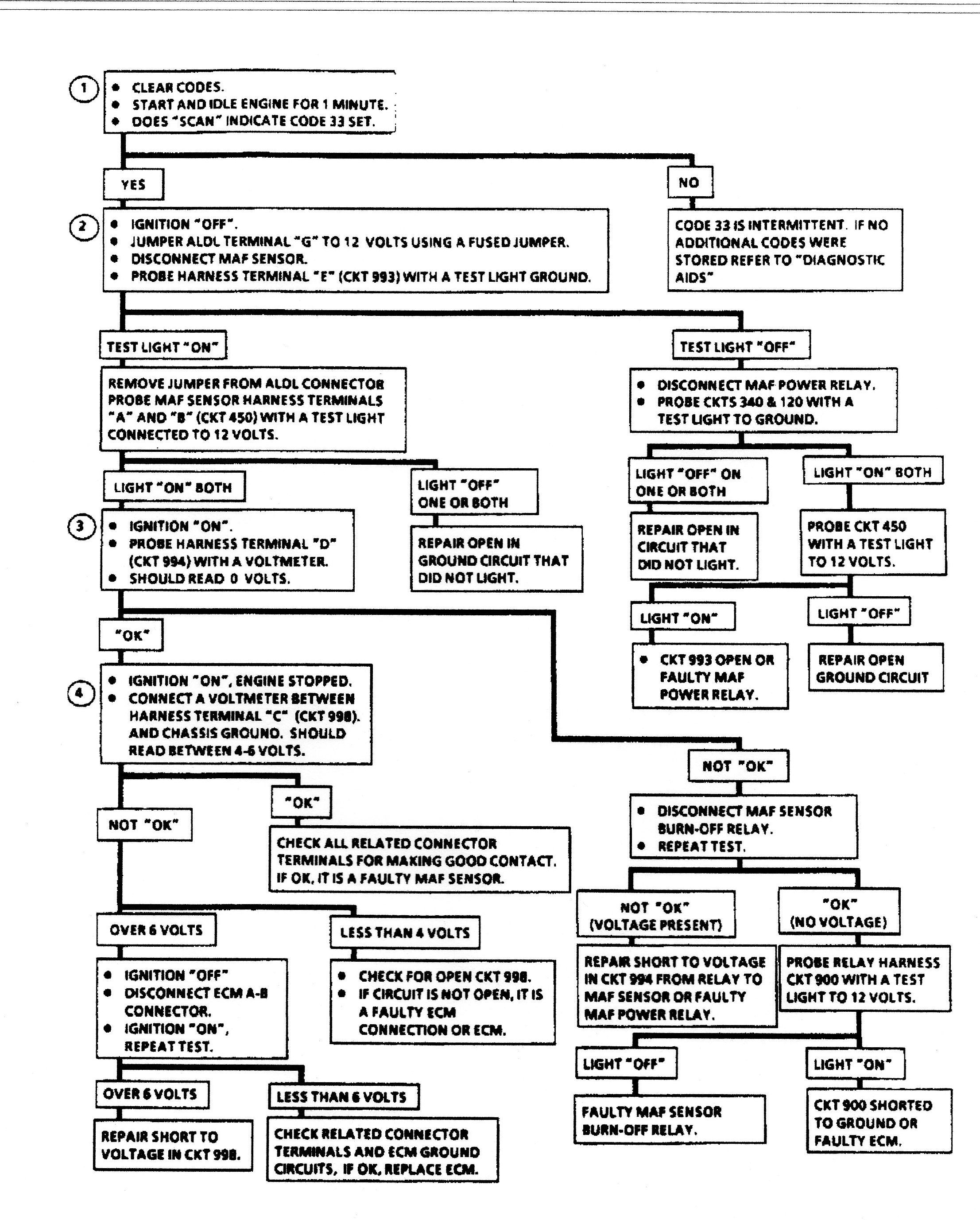

I got it, my burn off and maf power harnesses were connected to the wrong relays. Here is a flow chart for code 33 just in case if anybody needs it
