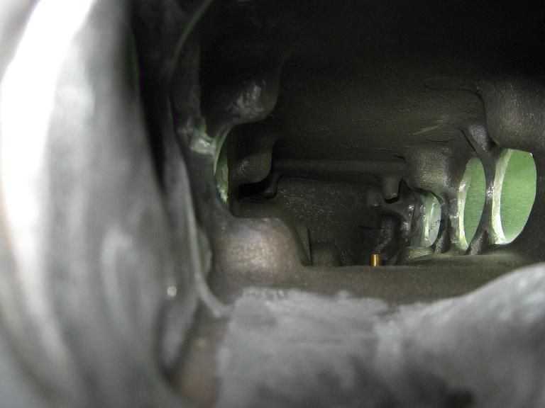

Couple recent pics of the plenum being cleaned up, and the finished based intake after being ceramic coated.
Attached Thumbnails Here's goes the crazy 305 TPI Build-intake2.jpg   Here's goes the crazy 305 TPI Build-plenum.jpg   Here's goes the crazy 305 TPI Build-plenum-inside.jpg

Here are a few more pics of some recent work..
Attached Thumbnails Here's goes the crazy 305 TPI Build-plen1.jpg   Here's goes the crazy 305 TPI Build-plenum.jpg   Here's goes the crazy 305 TPI Build-presscompare..jpg

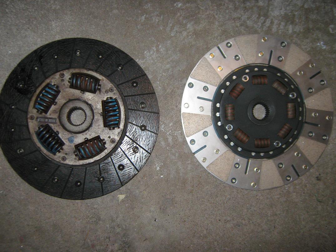

couple more
Attached Thumbnails Here's goes the crazy 305 TPI Build-pressold.jpg   Here's goes the crazy 305 TPI Build-presspl.jpg

couple pics...
gasket matching on the intake side, polished exhaust runners, and the engine sitting in the car.

That's cool, I only got the picture of what seem to be the intake ports with the masking tape around them. Are you running an aftermarket intake/plenum/TB or something?
EDIT: oh nevermind you edited your post lol. But I'm still wondering about that intake...

Here is a quick update with pics... I've got the engine back together and installed. Just need to get a few more things buttoned up and the exhuast bolted in..right now that's at the ceramic coating place.
