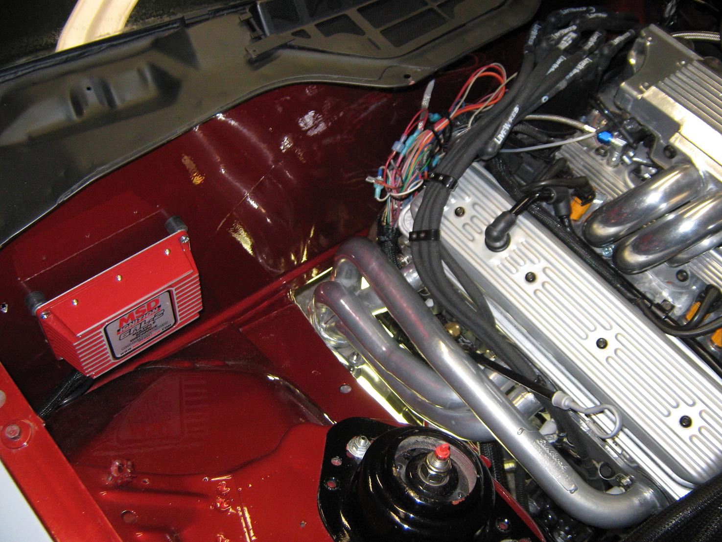

Here are some more. I upgraded my brake kit...
Attached Thumbnails Here's goes the crazy 305 TPI Build-battery.jpeg   Here's goes the crazy 305 TPI Build-wilwood.jpg   Here's goes the crazy 305 TPI Build-wilwood1.jpg

Here are a couple updates since last October. Can't believe it's been that long. The outer body has been painted, I've been spending a lot of time hiding wires, and putting things back together like trim, body kit.... etc!

It took me a while to re-route the harness wires from the engine bay to behind the dash. Here's a few updated pics
Attached Thumbnails Here's goes the crazy 305 TPI Build-engcompwires.jpeg   Here's goes the crazy 305 TPI Build-harness.jpeg   Here's goes the crazy 305 TPI Build-harnessremove.jpeg
