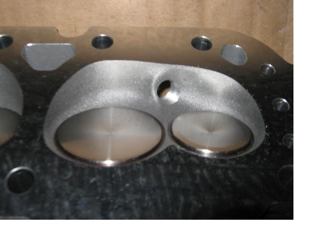

Here's what i have in mind:
  • Stock bottom end
  • re-use stock roller lifters (they check out nicely)
  • Comp Cam (.210in 220ex dur and 500/510 lift @50 with 114 LSA)
  • Trick Flow 175cc Street Heads polished exhaust and combustion chambers)
  • 1.5 Roller rockers
  • Ported base intake (will do myself)
  • AS&M Runners (bite the bullet)
  • Ported Plenum (already done)
  • 52mm TB
  • MAF mods (already done)
  • a/c delete
  • MSD 6AL (already have)
  • AFPR (already have)
  • Edel TES 1 5/8 (already have)
  • Random Cat (already have)
  • Flowmaster (already have)
  • ATI Intercooled Procharger 1DSC probably July '10
  • Serpentine belt drive set up
I believe superchargers generally likes a bit more on the exhaust cam side. Please make suggestions, recommendations, observations, etc please. I'm not new to the TPI world, or the aftermarket arena, but I'm certainly not an expert by any stretch.

Re: Here's goes the crazy 305 TPI Build
Trick Flow heads right out of box.
Unpolished Exhaust Ports
Polished Exhaust Ports
Attached Thumbnails Here's goes the crazy 305 TPI Build-trickflow.png   Here's goes the crazy 305 TPI Build-exhaustports.png   Here's goes the crazy 305 TPI Build-polishedports.png

1st Pic is gasket matching the intake runners on the head. They are pretty close.
2nd PiC is of the teeny weeny combustion chamber.
3rd is my best attempt at polishing the combustion chambers without removing the valves.
Attached Thumbnails Here's goes the crazy 305 TPI Build-gasketmatchingintakerunners.png   Here's goes the crazy 305 TPI Build-tinycc.png   Here's goes the crazy 305 TPI Build-polishedcc.png
