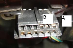

Sounds like you have terminals A and B jumpered. That cant be though ...Code 12 comes on in diagnostic mode, when you jumper A& B to check for trouble codes....code 12 means everything is good...Your getting this after the car is started?....no way, impossible

Then there is nothing wrong...Code 12 is is good(you only want to see code 12 flashing)......No trouble codes are stored in your ECM...If other codes appear other than 12 then there is a problem with one of your engine sensors or a related component

Are you clearing the ECM by disconnecting the negative battery cable? Do you have a scanner connected to the ALDL connector to monitor if codes are present when running? As Crusher stated code 12 is the normal flash code; if you are jumping terminals A & B and the check engine light comes on and the fan runs this is normal. If the check engine light comes on after normal operation and running with your jumper disconnected than there is a problem.
