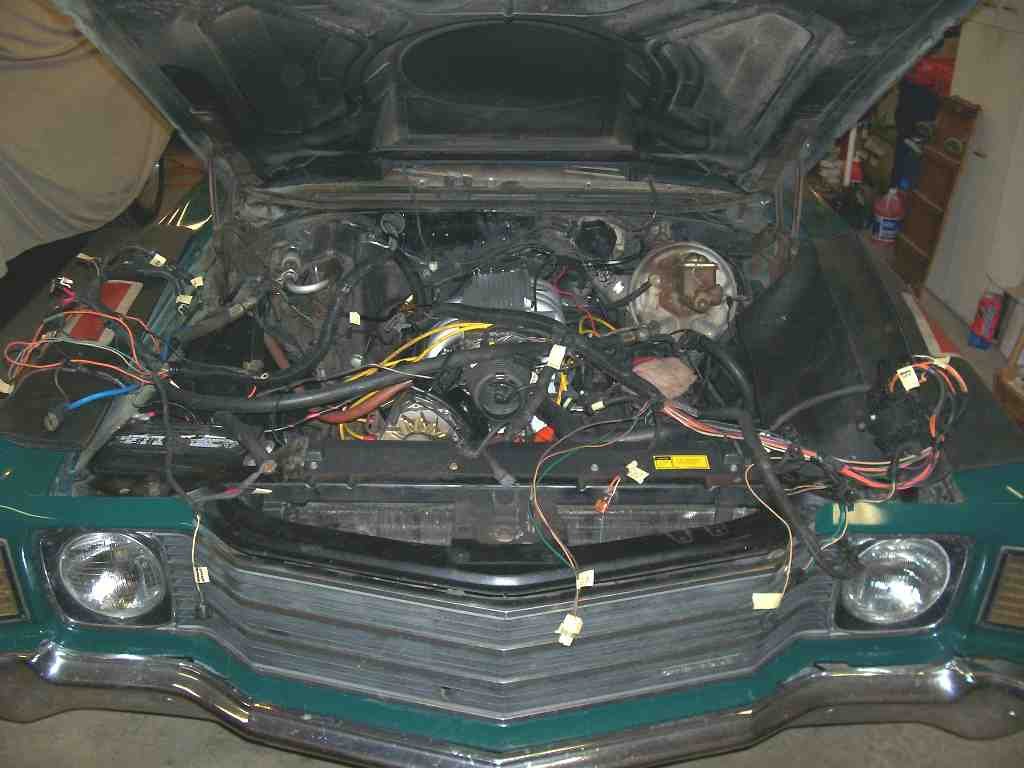

First, your concept is not that far out. It's been done before (by me) on various vehicles:
TPI should be a good fit for that application. A MAF TPI would be easier to tune, more forgiving, and should flow plenty for a low-end torque application such a a Blazer.
Fuel mileage and driveability should easily improve, but it would be even better with an OD/TCC lockup setup, which may be a challenge. IIRC, the Blazers of that vintage were using a Borg Warner XFER case, and may not fit up well with a later OD auto trans.
