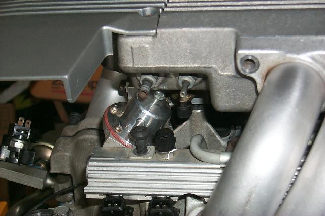

wow, I can't believe what I'm hearing! $500+ for replacing a fuel pressure regulator???
I definitely need to get into the auto repair business and become a millionaire!
anyways, like closer said, it'll take 25mins, no more than 26mins and thats if you stop and go to Pizza Hut and come back...
you'll just have to loosen 10bolts from the plenum. 4 for the throttle body, and 8 for the runners (4per runner set). Then unplug the vacuum lines from the back. Also remove the 3bolts holding the throttle cable bracket. Thats it. Lift of plenum. Since it was just rebuild, it should slide right off and not need to worry about sticking old gaskets. Like stated above, remove the perimiter bolts around the FPR and remove torn diaphragm and replace with new and reverse the process.
Its not hard at all, just a handful of bolts to keep track of.... Here is a pic of what you'll see under the plenum and the 4bolt holes on one set of runners...

no, you don't need to remove the fuel rails at all. Honestly, you're trying to make it more complicated than it really is. The fuel pressure regulator just sits on the box. The AFPR makes the top of the box. The diaphragm is in the middle, sandwiched between the hat (afpr) and the box...I found a picture of the the Holley unit AND a better angle than mine. I think the fittings on my fuel rail (the fuel pressure sender for my guage, and nitrous hookup) is distorting the picture. Here is EXACTLY how yours should look
Here is a pic of the diaphragm
Here is a pic of the diaphragm sandwiched between the AFPR and the "box" base...
P.S. That Holly unit should come with plenum gaskets to use if need be, so you don't have to worry about purchasing them...

Okay guys so I swapped over my new AFPR and i have everything buttoned back up. My questions is, does anyone know the tq specs for the bolts around the AFPR and the specs for the runner bolts as well as the specs for the throttle body bolts. Also, I don't need to put any kind of lock tight on that do I? just torque specs right?

I haven't used locktite and been fine. As far a torque spec... I just play it by ear. And make sure there aren't any leaks. Its aluminum so its easier to strip the bolts...

Yea I just figured that out. ****!!!! Anyone one know where i can get some replacement bolts for this now?

which ones did you strip? either way they sell the bolts in autoparts stores or any home improvement stores. They are metric I believe. I swapped out all my stupid torx bolts for regular allen head bolts...

Awwwww thank god. I stripped out two on accident on the FPR cover. But if I can go to Kragen or Lowes and grab some that would be super awesome. Do you know the size btw?

Allen wrench thru the vacuum port I believe. I think the Holley has an external ring that can be turned.

I like the Holley design best, since its easier to access. My BBK has a bolt on the top of the "hat" and its a BITCH to get to with the plenum on...

Yeah hopefully that psi tuning dial will help me get my psi set quickly with minimal effort. shoulf finish project tomorrow, my first day off work in awhile.

a few final key points:
1.make sure you disconnect AND reconnect the vacuum lines on the back of the plenum (specially the big one going to the brake booster)
2.also don't forget to unplug and plug in the AIT (air intake temp) sensor on the bottom of the plenum
3.Adjust FPR with vacuum line off...

Okay so i unplugged the vaccum line from the AFPR and the plenumn, but im getting no reading on my actual guage. Does anyone have any experience with the accel fuel pressure guage? I cant seem to figure this part out.
Just to clarify, the engine should be running to check the fuel pressure. I suppose you could cycle the key on and off several times to build up pressure for a ballpark value but ideally she needs to be fired up and idling. The gauge will read zero if you just hook it up and do nothing else.
And a note for the Holley unit, if that's what you wound up with: You'll probably need to file the underside of the plenum a little to clear the large **** on the regulator. It's in the directions and mine wouldn't fit without it.

But it is running and still nothing. I screwed her onto the schrader valve as tight as I cold get it but I didn't get a reading at all. Any suggestions.
