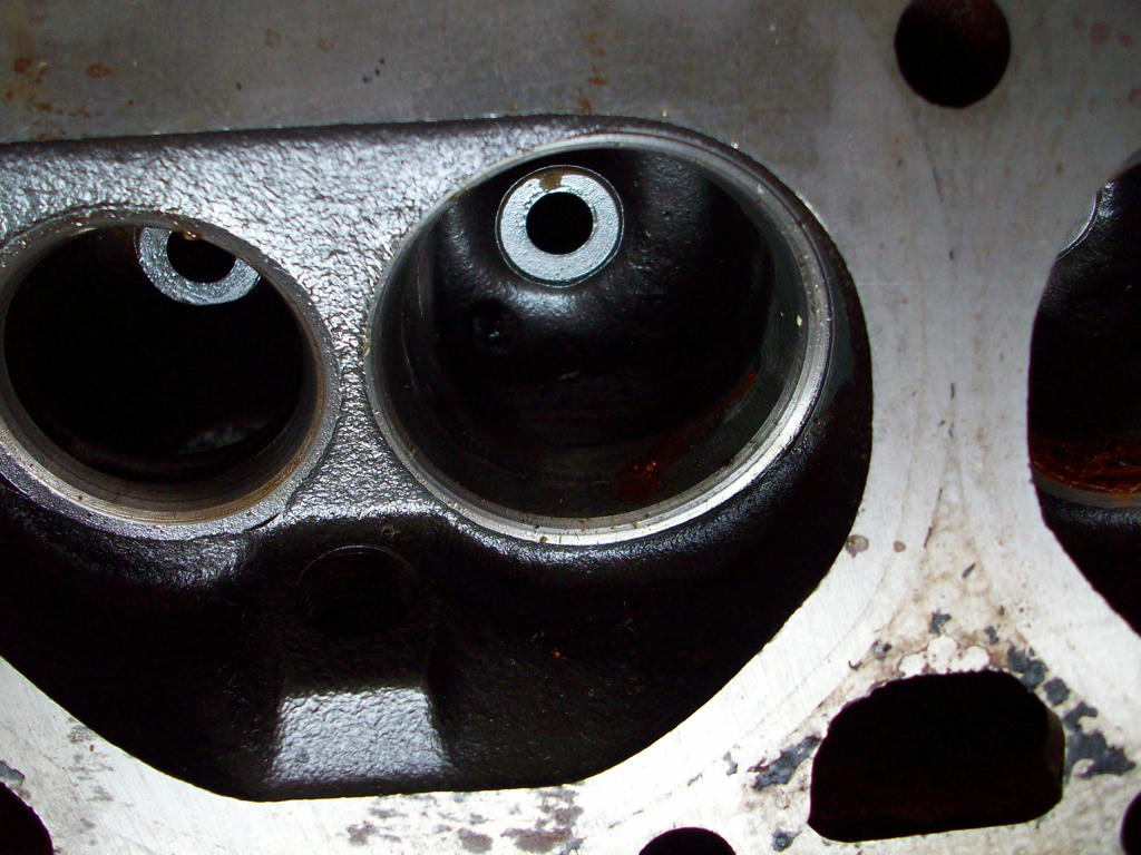

Here is what they looked like installed before I took it apart.
Here is what the seats look like with out the valves

Backcutting gets rid of the sharp ridge on the back-side of the valve head, and gives a smooth radius between the 45* cut on the valve and the stem area.
Here's a picture to roughly show the difference.
http://www.thedodgegarage.com/turbo/turbo_backcut.jpg
Your exhaust valves have a very large ridge, though backcutting is more effective on the intake side. You can backcut and/or radius both intake and exhaust if you want. It adds a significant amount of flow, especially at lower lifts.
Your valve-seats in the head look pretty good.
