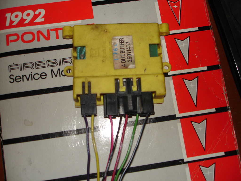

any pictures of what the buffer box looks like would be very helpful

Yes, it can also be white-ish

thank you very much! i will have to go out and look tommorow. also, what if i dont have it?

All TBI cars got them. If your speedo works at all, you will have it
