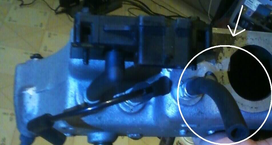

hey guys i need help with the vacuum hoses for my 91 speed density tpi setup. i found this thread which has alot of good info but its for an older setup i was wondering if my setup would be hooked up differently??? also what does the hose i have labeled connect to? https://www.thirdgen.org/forums/tpi/...rs-i-need.html

A 3-way check valve that goes to your hvac and cruise control.
