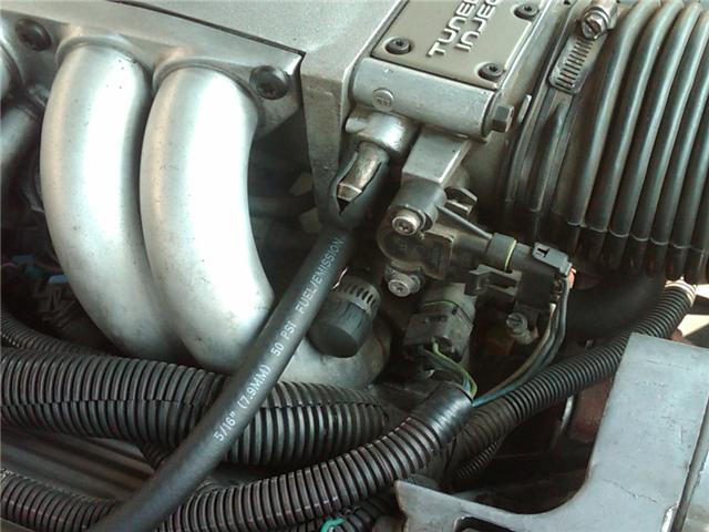

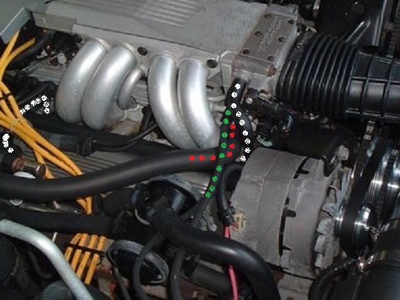

Ok, here ya go... None of my own pics are close enough to see it clearly, so I did a search of the net for pictures of TPI engines, and this is one of the better ones I found for seeing the hoses connected to the throttle body. It's an '86 Trans Am.
Top port: there's a short hose connected to a metal tube, and that tube curves downward(you can see it disappearing behind the alternator), then runs along the base of the runners back to the breather in the valve cover.
Middle port: small hose, and it goes over to the evaporative emissions (smog/charcoal) canister, and it connects to the solenoid on the top of the canister.
Bottom port(throttle body coolant exit port): it's a heater hose... usually connected to the heater diverter valve. But in this pic, the person has deleted the diverter valve and has the heater hose going directly back to the heater core. This is the port that can be bypassed, so yours might not have a hose connected there.

Here it is again, but I've cropped that area out of the pic, enlarged it, and I've done some really hi-tech colorizing LOL.
top port, white = valve cover breather. You see it disappearing behind the alternator, then it turns back and runs underneath the wiring harness at the base of the runners, and you see it again at the back where it comes up and over the harness and connects to the breather.
middle port, green = evap canister hose. Your canister is probably on the drivers side, being a Camaro, so your hose would have to turn toward that direction after it leaves the throttle body.
bottom port, red = throttle body coolant passage exit. That's where the heater hose exits the throttle body and would normally connect to the heater diverter valve before running to the heater core. In this pic, he's deleted the valve, and the hose runs to the heater core directly.
so, now i see whats all messed up...my top one is the one thats poorly blocked off, and the MIDDLE one is whats going to the breather cover! so im going to switch em around and run a new hose to the black canister, and yes it is on the driver side...ill post pics also. wow i sure hope this mix up fixes my problem..

alright, so i swapped hoses and had to o to the store to get a 3/8 size hose for the top connection, ran it to the valve cover. and the middle one i routed all the way to the charcoal canister with 5/16 size hose, bottom one capped off and bam started her up, ran kinda funky for a min and then idled nice and smooth..reset the comp and started back up and no more code 34!
thanks for the help everyone and i sure hope this post can help others in the future if theyre doing a swap or something.
took it for a ride and it was hella more powerful even with the bad knock sensor still, so im happy for the moment, didnt know that was causing that much of a problem
