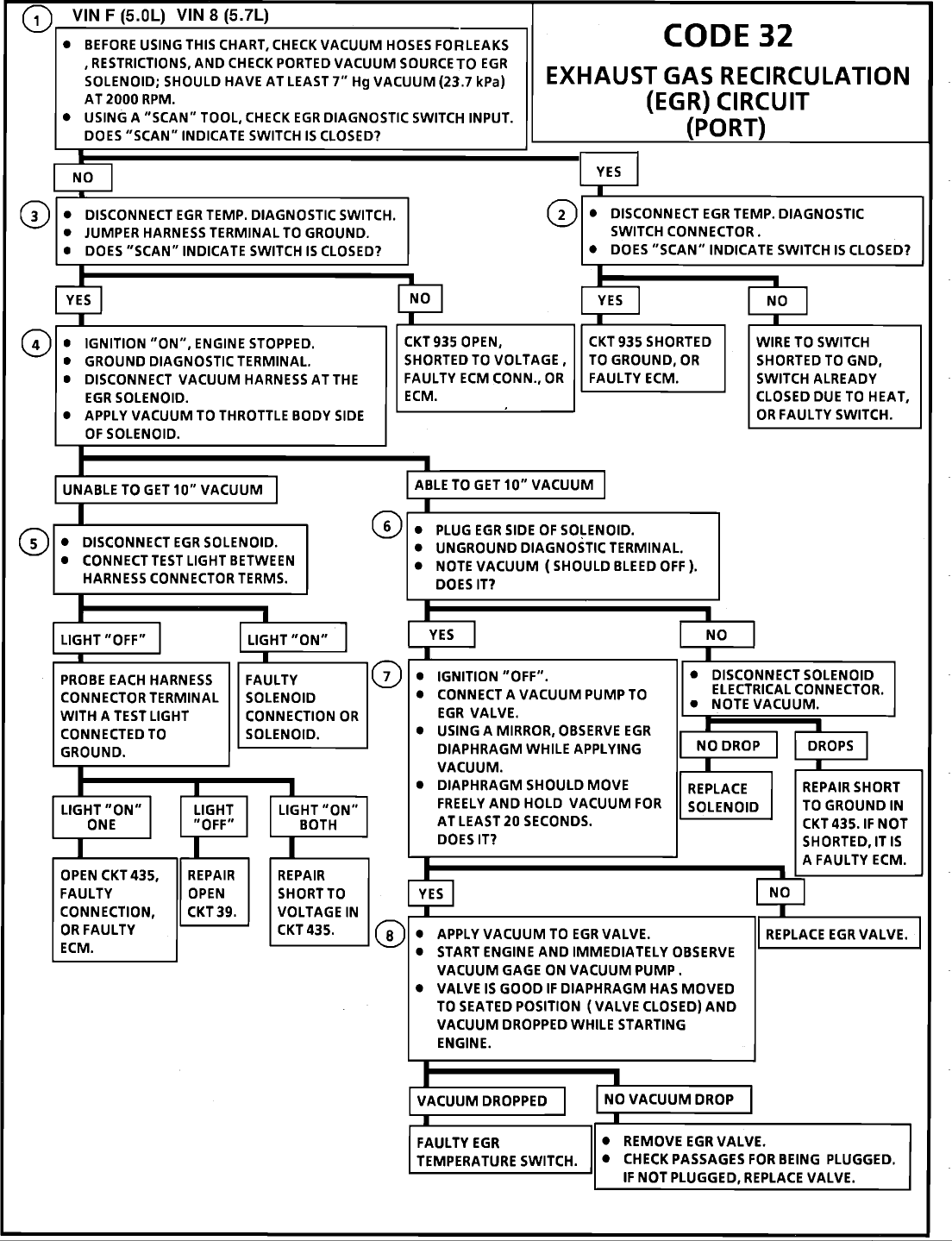

Oh snap, that's the pre-`91 chart
Here's the info/diagnostics for code 32 that applys to 91-92 Z28 305/350
CIRCUIT DESCRIPTION:
The Exhaust Gas Recirculation (EGR) valve vacuum is controlled by an Electronic Control Module (ECM) controlled solenoid. The ECM will turn the EGR "ON" and "OFF" (Duty Cycle) by grounding CKT 435. The duty cycle is calculated by the ECM based on information from the coolant temperature, air flow and engine rpm. There should be (NO EGR) when in park or neutral, Throttle Position Sensor (TPS) input below a specified value, or TPS indicating Wide Open Throttle (WOT), or the MAT sensor below 15~C (59~F). With the ignition "ON," engine stopped, the EGR solenoid is de-energized and by grounding the diagnostic terminal, the solenoid is energized.
The ECM will check EGR operation when:
TEST DESCRIPTION: Numbers below refer to circled numbers on the diagnostic chart.
- Vehicle speed is above 30 mph
- MAP is as listed in table below
- TPS is between 5% and 30%
- No more than 0.4% change in TPS
- By grounding the diagnostic test terminal, the EGR solenoid should close and hold vacuum. The vacuum may bleed off slowly, but this is not considered a fault.
- This test will determine if the electrical control part of the system is at fault, or if the connector or solenoid are at fault.
- By plugging the EGR valve side and ungrounding the diagnostic terminal, the solenoid valve should open and allow vacuum to bleed off through the vent
- With the engine not running and vacuum applied to the valve, the valve should move to the fully open position.
- Due to this engine using a negative back pressure valve, the valve should close when the engine is cranked over.

I just installed a used EGR solenoid, haven't driven long enough to see if it works or not, but sooner or later its gonna go bad. So I'll be back to square one anyhows since they don't make the exact one for the car any longer.
But on the chips. These performace chips will all have the EGR code on them. By law you cannot take them off for emission purposes. Yeh Like we give a **** right! The guy on ebay is the fastest and safest bet. If you decide to burn your own prom. The steps of programming, soldering on a new one, and all the equipment will cost you around 80-200 dollars. Depending on how you shop. But the nightmare is the soldering on a new prom or create a ZIF bracket for future use. Still that's buying the items, programming a new prom, de solder the prom off the memcal, solder back on a programed prom to the memcal, and then installing it back on the ecm.
This is a PIA if you ask me.
http://www.ebay.com/itm/190645297857...S:1123&vxp=mtr guarantees his product for 15 days. If not happy he'll refund you and it's just detach the memcal and install for $89. No soldering required. That's it!
I use this car as a daily driver. I'm not going to go crazy on all this programming until I decide to turn this into a Twin Turbo Race Car. But even if I decide to or not, I'm just going to do this simple fix for now. Because I can't stand seeing that Service Engine Soon light any longer.
Hope this helps.
