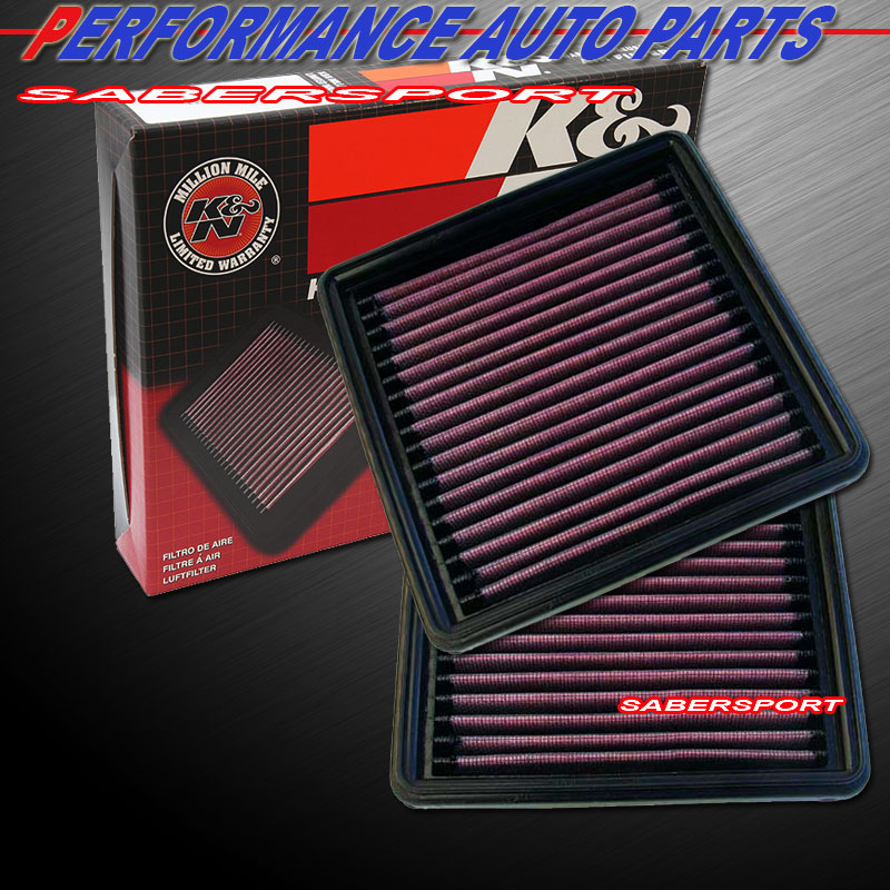

Im about to buy some Summitracing products guys. I want to buy some K&N air filters but I saw that Spectra makes the very same filter for half the cost. THey are both made of cotton so whats the difference?
K&N
BrandK&NManufacturer's Part Number33-2008-1Part TypeAir Filter ElementsProduct LineK&N Washable Lifetime Performance Air FiltersSummit Racing Part NumberKNN-33-2008-1UPC024844090140Air Filter StylePanelLength (in)6.625 in.Width (in)6.625 in.Height (in)1.625 in.Filter MaterialCotton gauzeFilter ColorRedQuantitySold individually.
Spectra (as an attachment)
BrandSpectre PerformanceManufacturer's Part NumberHPR3915Part TypeAir Filter ElementsProduct LineSpectre Performance hpR Air FiltersSummit Racing Part NumberSPE-HPR3915UPC089601004167Air Filter StylePanelLength (in)6.690 in.Width (in)6.690 in.Height (in)1.260 in.Filter MaterialCotton gauzeFilter ColorRedQuantitySold individually.

same thing....your paying for the name, with the k&n stuff.

actually, if your car is a MAF system, you run the risk of contaminating the MAF with the filter charge oil that most cotton filters need. oe paper is fine too.

The K&N filters will has longer then the car with the correct Maintenance (that means follow the instructions and DO NOT over oil). Bought mine in 1988 and still using the same filters (again proper maintenace).

Love the input guys. I never thought about the fact that the cleaning/charger oil can contaminate the MAF Sensor. I might just stick the the paper filter then.
