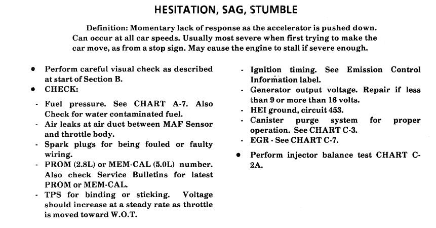

Other possible solutions if stalling occurs after installing a VSS. This is straight out of my 86 GM Camaro Shop Manual

I appreciate the input but I am dealing with a situation that sees the engine die when rolling to a stop not a hesitaion or stumble.
