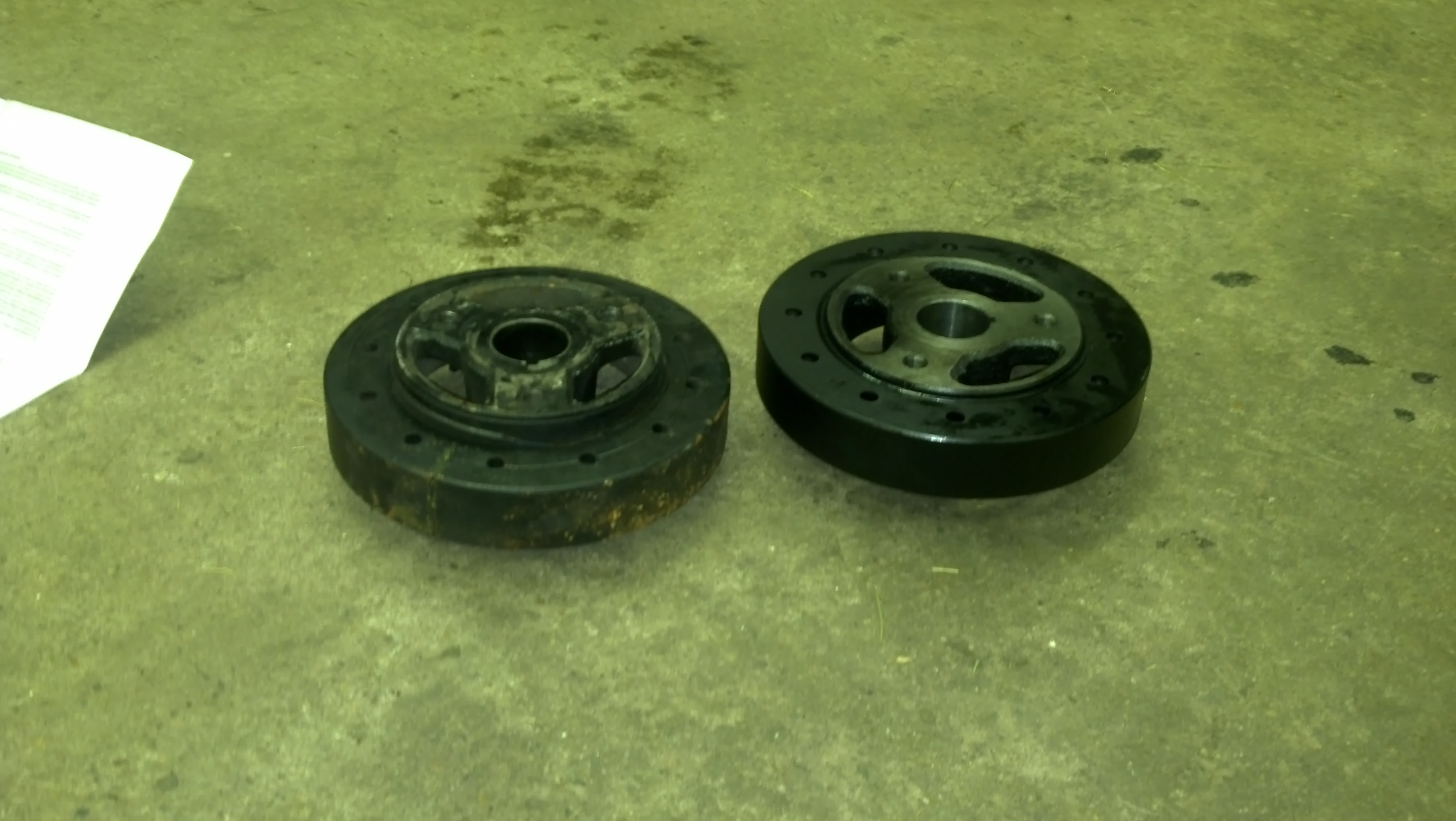

Old Jun 14, 2012 | 05:20 PM
camaroz28850's Avatar
Joined: Jul 2007
Posts: 8
Re: 85 Tpi problems
So I did the ECM swap and it didnt fix the issue. I was talking about it with a neighbor who was a mechanic and he offered to come down and take a look. He suggested that we do a leak down test to make sure there was nothing wrong with the motor. As he was about to test the first cylinder he noticed that the Harmonic balancer was broken. I looked back at pictures I had from when I did the 350 swap and it was broken back then. After I installed the new balancer I checked the timing and I ended up having to pull the distributer and reset its position. The car runs so much better now. It still smokes a little but atleast I can drive it now. It sat for way to long. This is a pic of the balancer next the the new one and a few of the car.
