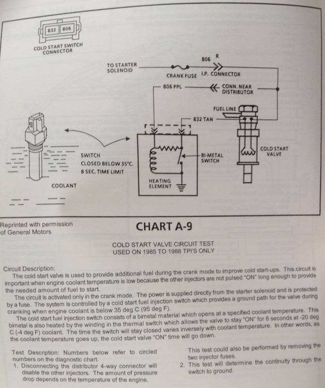

Re: Cold Start Issues
When the ignition switch is turned to the crank position power is sent to the purple and white wire of the cold start timer switch and the ninth injector. The timer switch controls the ground side of the injector.
If you are wanting to go to the 89 programing send me a pm I can assist with the upgrade.
