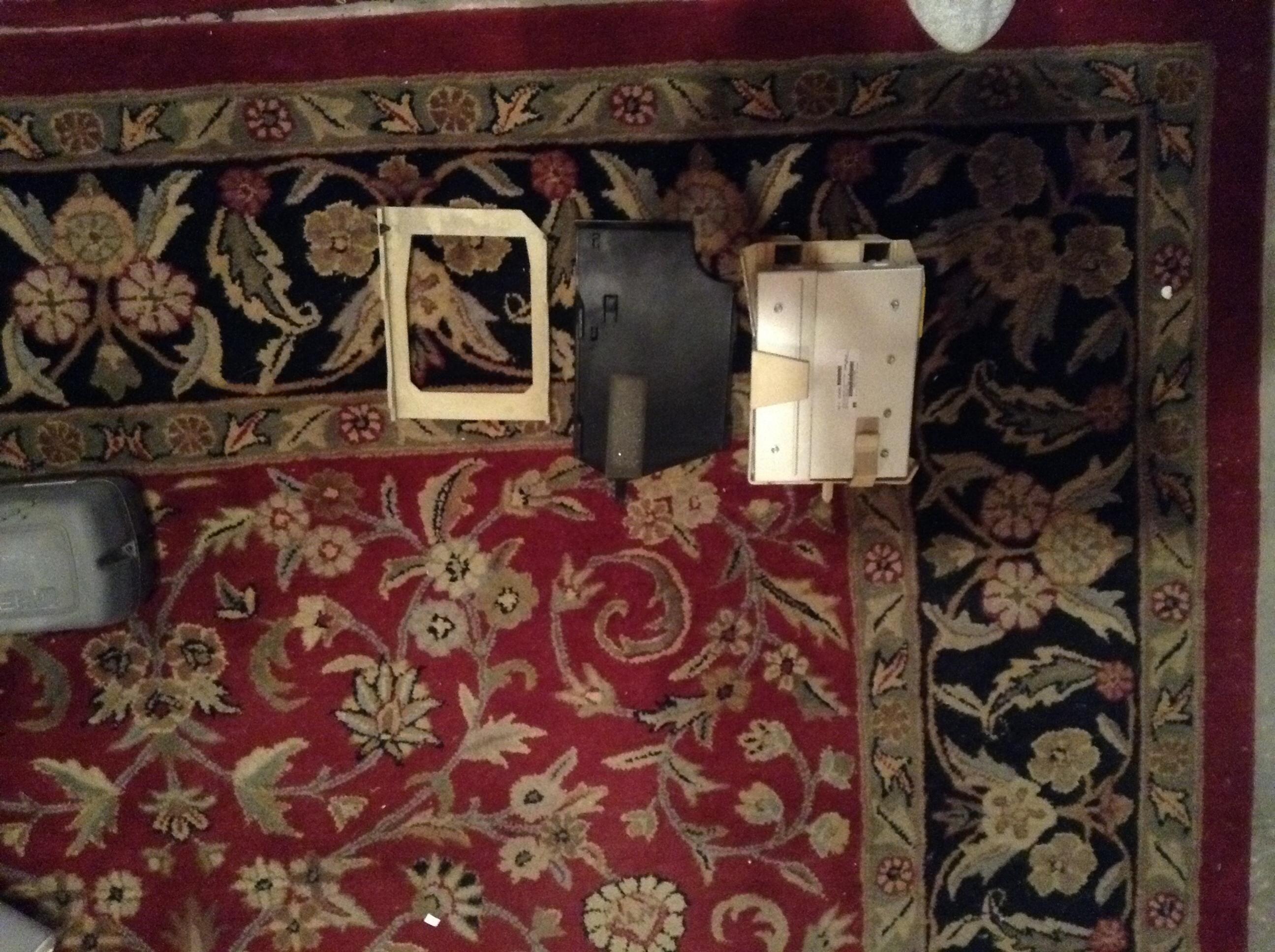

Maf to sd how do I mount ECM
My car is an 87 that came with the smallest ECM mount. I bought a mount from a 92 but it's much too long. What have yall been rigging up to mount the 7730 in an old car

The one on the left is the 90-92 it is the same length as the ones to the right 86-89 and the 85 that uses a pin inserted to the ecm to go into the speaker mount hole.

Sorry the pic posted upside down

Something must be weird about my car it's an 87 and came with the mount that inserts a pin into the top of the ECM. I have all three mounts pictured and the black one and 91-92 are longer, and the pin is a different shape and diameter. The older style pin was round where the new one is a cross. Maybe a new speaker mount will solve my problem
