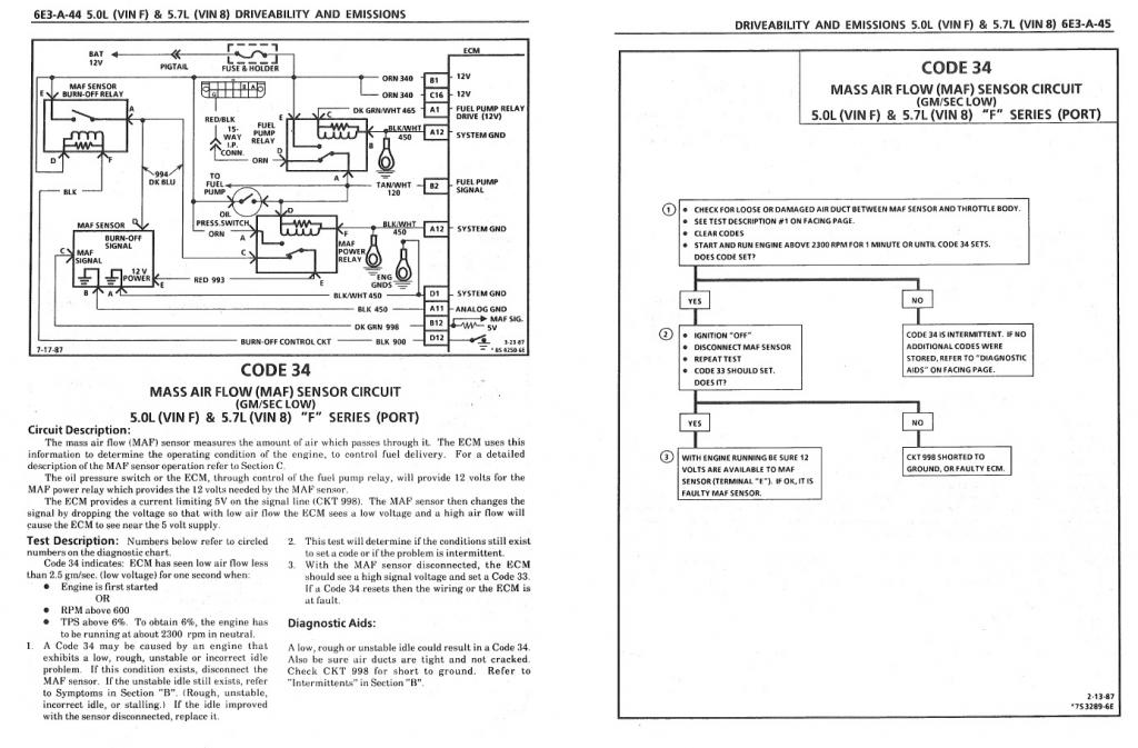

Thanks for the pics, I tried to do as it shows in the flow chart, but when i disconnect the new MAF the car no start
I do have a service manual printed and in PDF form for my car, just cant follow it, other ideas? Could it be a relay?

yes it very well could be the MAF power or burn off relay. since theres no way I know of to test them. try another set. it couldn't hurt

Welcome to MAF electrical issues. Replacement of the relays when installing a new MAF used to be common practice.
Replace them and check the harness wires going to them.

Oh and my service manual says no start cause, defective MAF

update to my update
Lesson learned, dont let others work on your car
I beleive I may have found why the first MAF gave a code 34, the wiring to MAF sensor was stripped in spots and the inside exposed, touching one another.. end of last season the ac delete pulley, that was installed at shop, broke off, this caused the MAF to get the hole on the underside where the electronics are, doesnt affect air flow, the idiot at the shop didnt fix the wires
Could the exposed shorted wires be the cause of the original code 34?

Re: new MAF code 34, but runs amazing?
Very good example of how a simple inspection of all the components in the affected system can save a lot of $$$ and time. I am an auto technician, NOT a parts guy, other mechanics will know what I'm talking about. Some customers might not like that as it takes an extra hour or two, but at least when they have to order a 500 sensor its not going to come back 3 days later with the same code.
Here is my own personal code 34 experience, on my own Trans Am, quite recently.
Would throw code 34 while vehicle is driving. Basically, clear code and would not store code 34 while moving around the parking lot into shop etc. Look up procedure and find same relay bulletin, confirm numbers and perform step by step procedure diagnostic. Everything tests good but as time goes on code is now setting hard all the time. This all happened with in 2 days. About one week after buying the car.
Decide one day after work to put my big boy pants on and starting doing a complete wiring harness inspection after it threw a burn off failure code as well, its too bad I didn't do it earlier, but found the problem.
A simple part failure, a few wire loom retaining clips had failed on the cooling fan shroud and the wiring harness was being forced into the pulley system on the front of the engine. When I first bought the car I noticed the wiring was not in place, but assumed it was just forgotten. SO I put them back in the retainers and didn't check them again until later on. This problem eventually caused the wiring to be rubbed through, the power wire to the MAF eventually was severed. This would also explain the initial intermittent code 34 appearing. When the vehicle was at rest or very slow speeds with the fan off the wire loom would somewhat naturally return to its original position against the cooling fan shroud.
