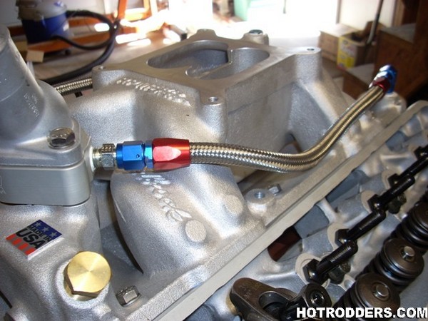

The Vortec TPI intake base has a rear coolant crossover passage, and a 1/8" NPT port. Is anyone using it? Does anyone have a picture of theirs?
Since I don't have room for a spacer at the thermostat, I figure any unused port at the front will work (9th/CSI deleted leaves at least one available).
Attached Thumbnails Whose using it? TPI Vortec base rear coolant crossover-tpi_vortec_intake_coolant.jpg   Whose using it? TPI Vortec base rear coolant crossover-coolant_lines.jpg

Coolant circulation from the back of the heads. It is supposed to help prevent hot spots in the rear. If you believe, or need that kind of thing.
https://www.thirdgen.org/forums/fabr...ines-rear.html
