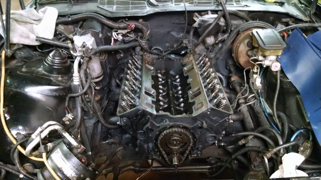

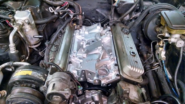

Recently I acquired a 305 vortec marine engine, the engine had the 059 vortec heads.
I also used the "395" marine cam during the build. While I was at it I threw some headers on it, with a new exhaust.
I used a chip from harris performance, to delete the EGR.
I have only driven it about 5 miles since completing all the work, but from the seat of the pants it feels like I woke my 305 up quite a little bit.
Here are some pics of my vortec head build.

I am most pleased with this upgrade, after I got the timing dialed in, the little 305 does have a lot more in it.
My short test drive today was way more entertaining than it used to be.
I can't wait to see what she'll do at the drag strip. I sure hope it will be low 15s, we'll see.
