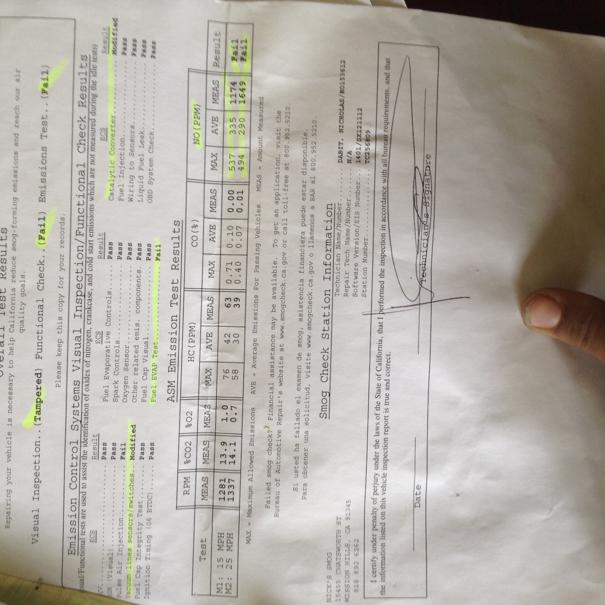

Here are the results from the last emissions test.
Getting the bolts in the runners along the bottom right now. Not as much of PITA as I thought it was going to be so far.

A concern of mine is the Cat Converter being marked as modified. That's an instant fail no matter what numbers the car produces.
Is the new cat that was installed 50 state (CARB) legal?

Because your car has evidence of tampering or outright failure for visuals it really is difficult to know why your car is out of spec for NOx. We can talk in generalities but until the visual fails are addressed it's just a guessing game at this point.
Unfortunately the visual portion of the results just show pass/fail and no detail as to why it failed.
I think your next steps would be to address the visual fails and re-test to establish a baseline and then go from there.
There is the option of a referee station but I doubt they would sign off on something that fails visual or shows signs of tampering. Even if they sign off, I believe the exemption is only temporary. You will eventually have to repair the car if you want to continue to drive it.
CA also has financial options where they will help pay for repairs but this too isn't a slam dunk.
Cant say with any certainty. Previous owner had it done. I don't know how they identify a aftermarket cat. Self report?
The car is almost thirty years old so if it was still an original cat it's guaranteed not to be functional.

If they fail you on the cat as modified again, ask why. It'll probably be lacking Cali compliance text if so.
