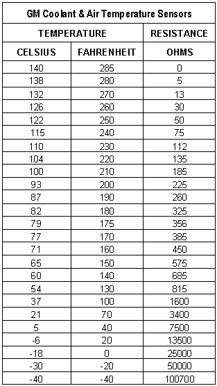

I'd start with a coolant temp sensor if I were you. If it's really reading 66* all the time it might be bad. Put a new one in and try that.

I had built the motor 2 years ago and put it in. I did put a brand new coolant sensor in, not saying it can't be bad, it would be par for the course at napa. I remembered my father has a 88 corvette he's trying to sell, I'll try the scanner and gauge on that too and see what it comes up saying.

6. your temp readout on the scanner being static at 66 degrees means the CTS is bad, or the scanner connection was no good. you can check a coolant temp sensor by just checking resistance across both terminals with a volt meter. You can find resistance vs temperature tables online with a google search. If the CTS is bad, i assure you it will run poorly.

The Matco scanner worked fine, turns out I'm an idiot and never reset it from when it was used on the corvette last, so it was setup for that car. May have been a problem too.

i put the scanner back on and entered the correct VIN info and it worked this time. here are some readings i got, incase you guys are interested at all (in italic are the corvette readings which i took yesterday, closest thing to this motor i have to this car - bold are my car)
O2 volts .31-.68 .62-.76
(new sensor)
Integrator 147 126-132
MAF 10 G/S 10 G/S
Coolant Temp 208 F 177 F
MAT 84-122 F (over some time) 075 F
(I dont know what this is)
RPM 775-850 1050
KNK Signal No No
EGR D/C 000% 000%
(i have egr delete)
Inj. P/W 2.6 ms 1.7 ms
Prom ID 4131 7861
Trouble code 42 34

Manifold Absolute Pressure/Manifold Air Temperature (MAP/MAT) Sensors provide precise measurements of manifold absolute pressure, manifold air temperature...
