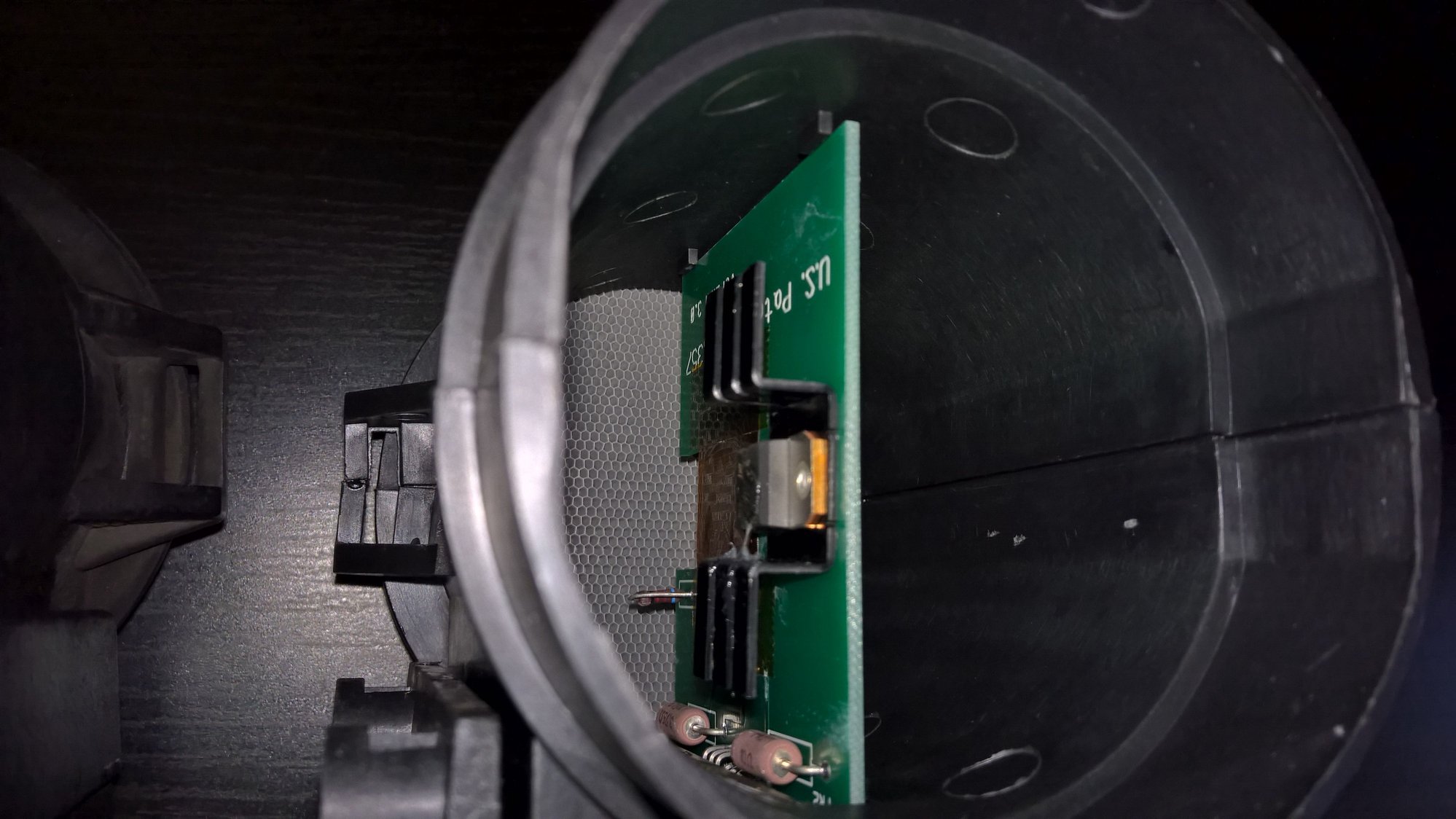

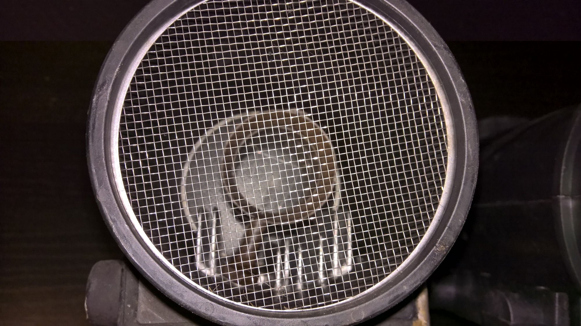

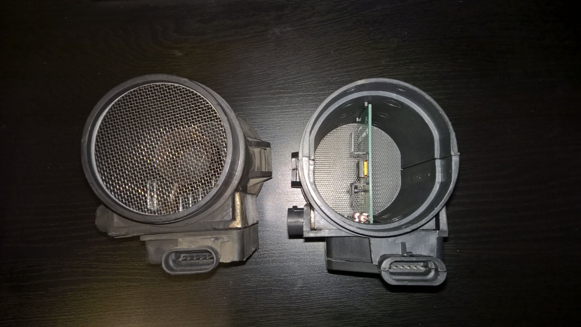

Parts arrived today... Quality of the Spectra Premium MAF is HORRIBLE. Sensor is leaking air all around the body seams which (unlike the stock one) is made of two halves. I just put some epoxy on the seams but I suspect it may leak air around the electronics housing too. Also it was very loose when installed in the air snorkel, so I had to put some electrical tape around it to cure this problem...
Internally it's different than the stock Bosch MAF (looks exactly like Wells or Rich Porter MAFs).
Look at the pics - feel the taiwaneese cheapness!!!
I have a bad feeling about this sensor, but I'll give it a shot... If it won't work then I'm switching to EBL flash.
