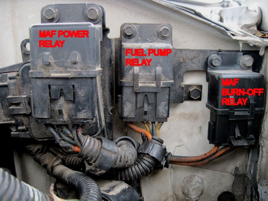

Thanks TTOP350, the afpr is brand new but I'll check the vacuum line. Do you know where the MAF burn off and power relays are located?

Drivers side firewall. BUT...not necessarily always in that order OR style of relay. HTH's
