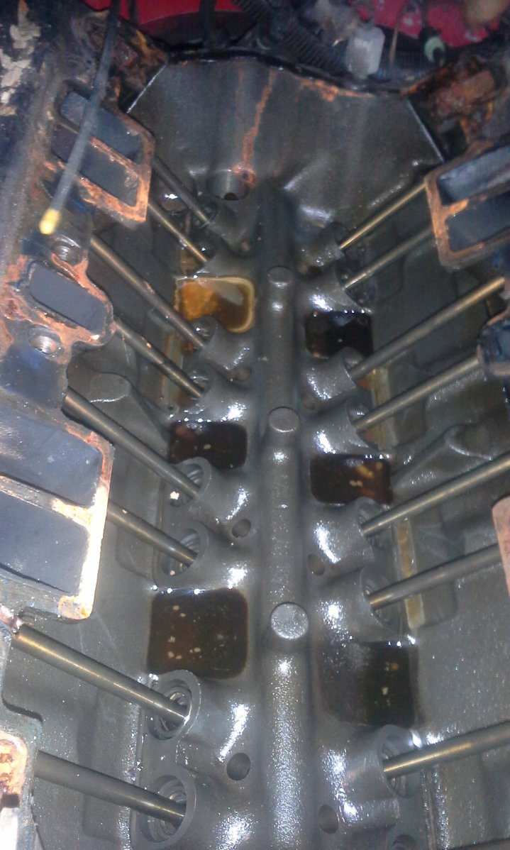

I pulled off the lower intake manifold, and found out that the block wasn't a roller block from factor or now.

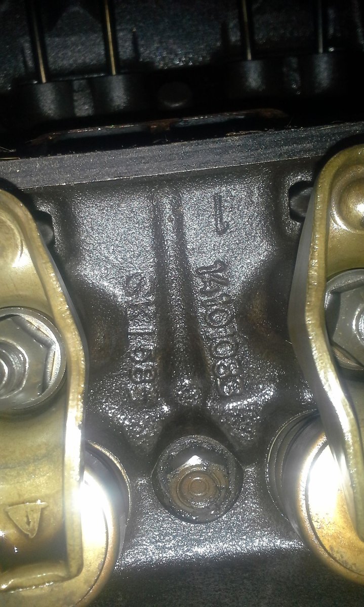

I also pulled the valve covers and was wondering what heads I have.

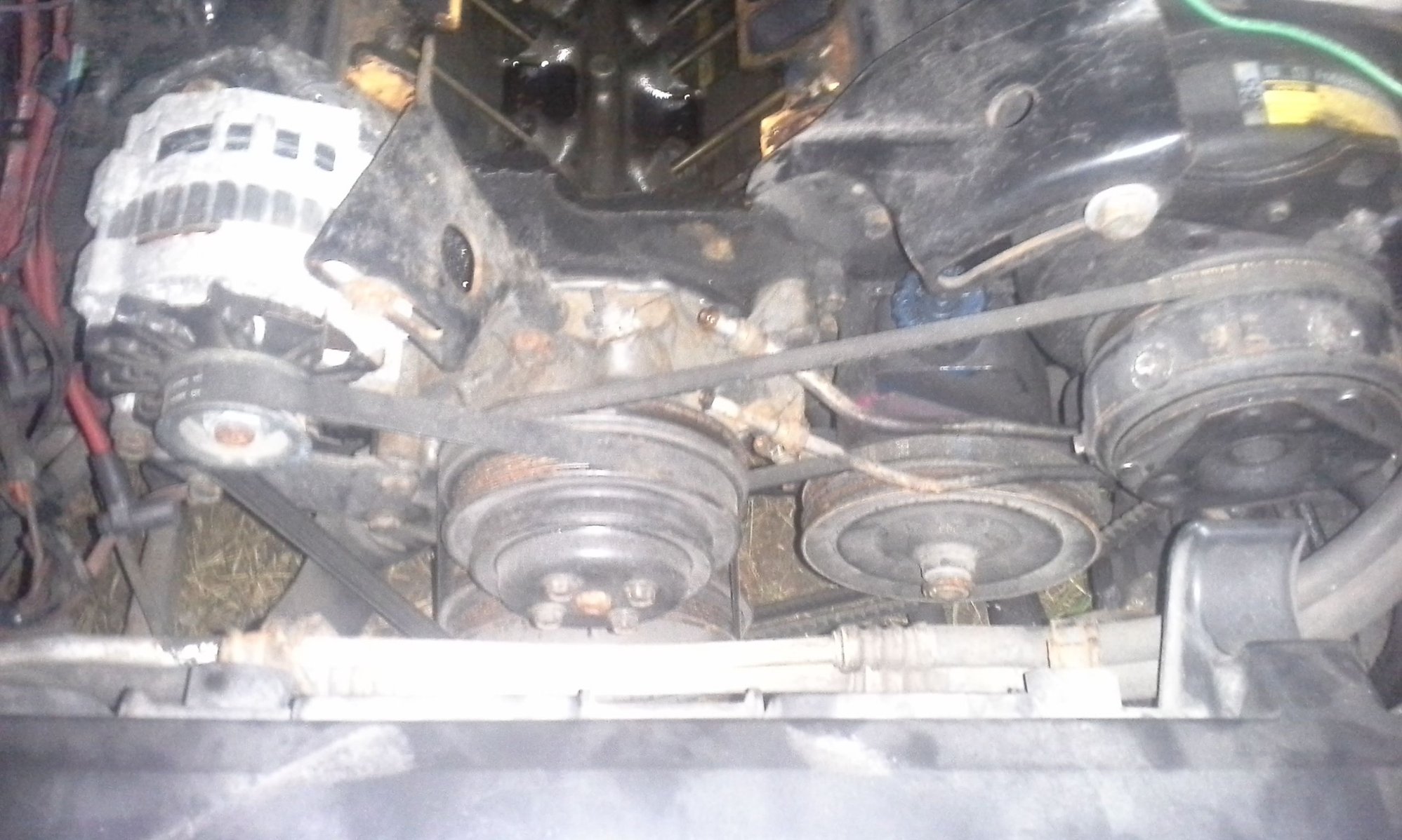

And the last thing for now, does this acc. set up remind anybody of a truck or camaro or a corvette?

Yeah I'm guessing that the block was a truck or van block. If you want to go roller it shouldn't be too bad to drill and tap for the provisions. Good thing you got 083 heads from an fbody, I'd rather have those over 193's.
Acc looks to be fbody unless someone sees something I don't. Been a long time since I had vbelts.

What is the suffix code stamped on the block pad, passenger side front where the head meets the block. The upper water pump bolt screws into the pad...the 2 or 3 letter code will give you a better idea of what engine (application) you have.
Looks like the oil dip stick is on the passenger side...so it's most likely a post 1986 one piece rear main seal engine to start with.
The 89 serpentine will work..might want to use the 89 water pump just in case.

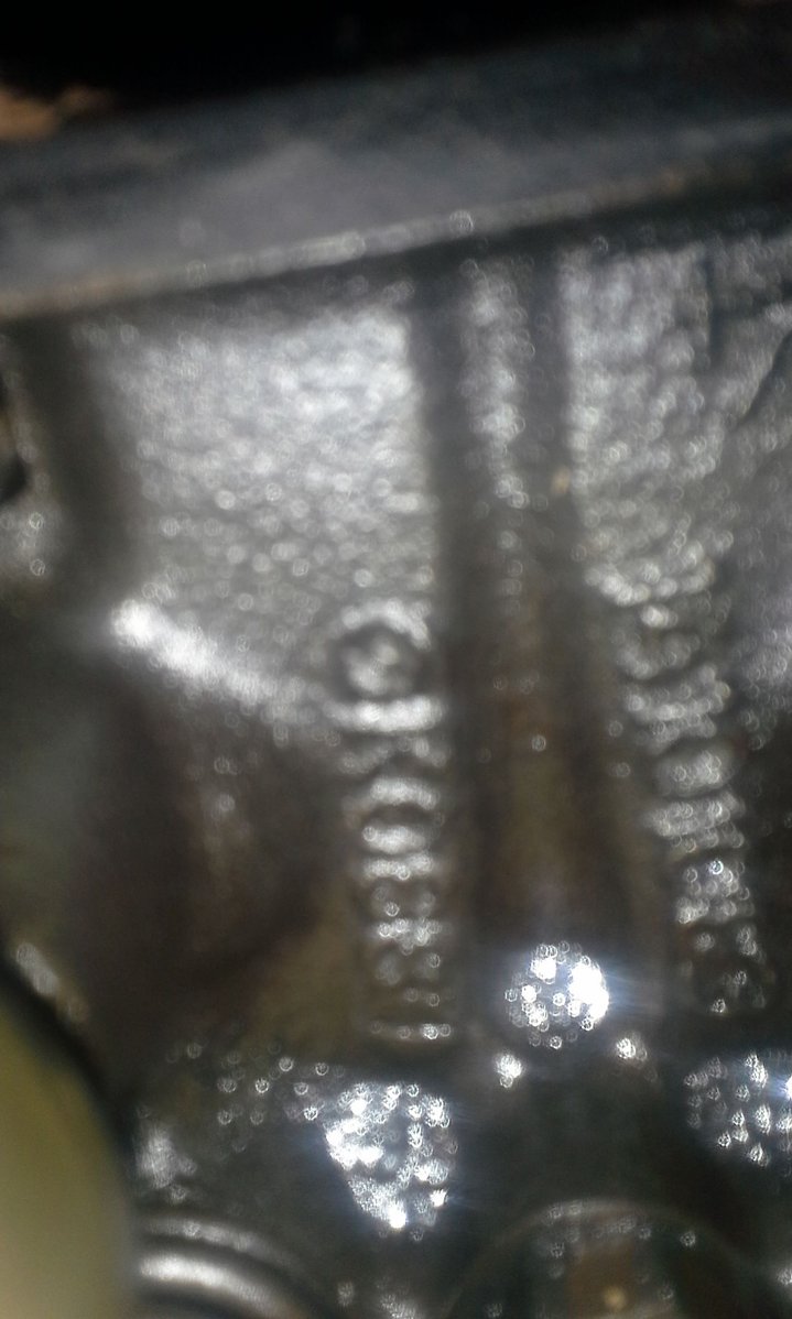

I tried to go get the code from the block pad, but I can't see or read anything on it. The oil and transmission dipsticks are both on the passenger side, like my '89 TA is.

Block could have been decked and that info went with it. I don't think it means anything as we know it's not an Fbody engine since it never had a roller cam yet it has 083 heads from an Fbody. It's clearly been changed around so where it was means little but what it IS means more. Pulling it apart and visually finding out what is there will be the only way to know for sure.

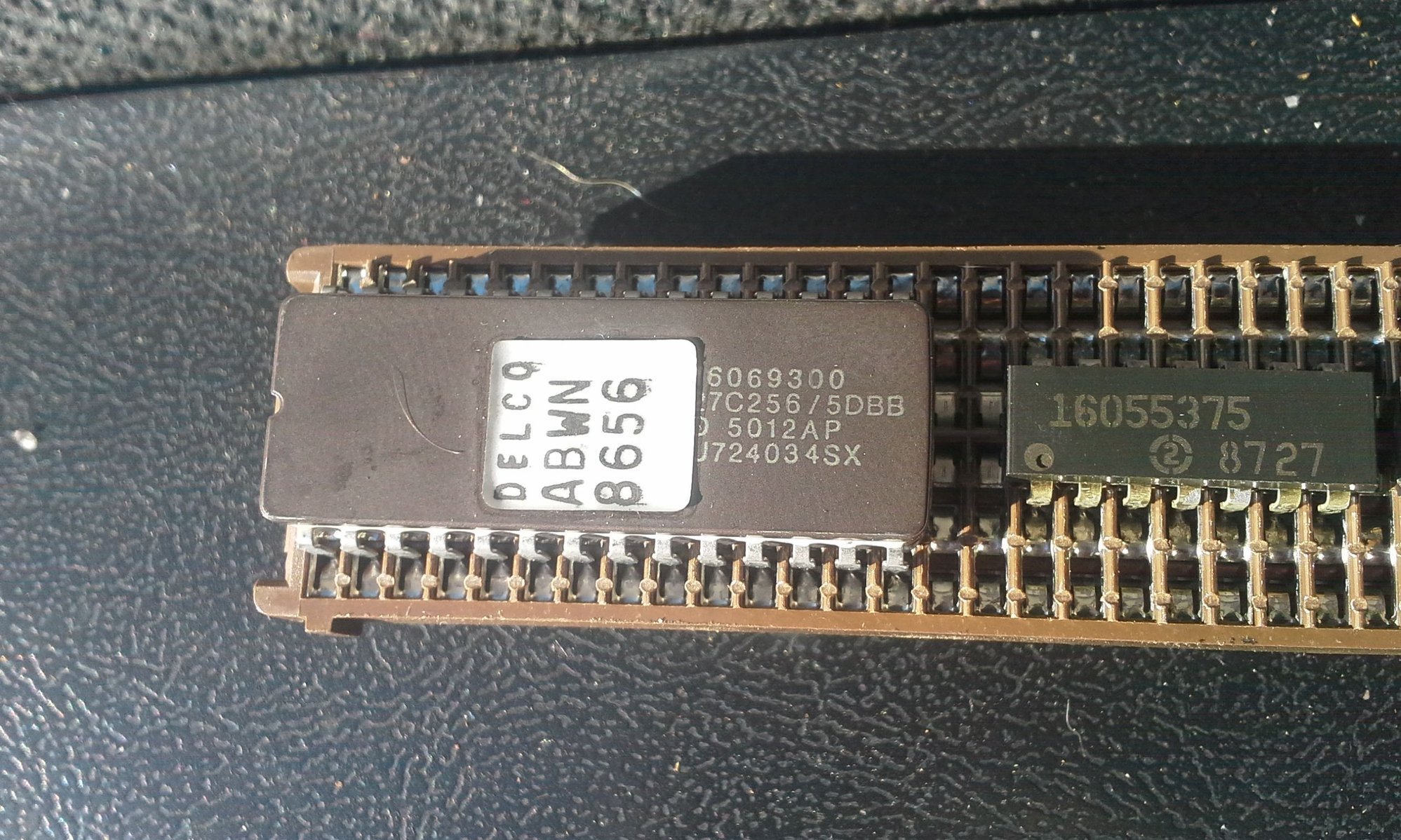

The video I posted earlier, in post #3, is the back of this car back and the tag that was on the car when I went and picked it up.. So I am to believe that the cam is there and that it did run with the TPI. But I do know that the engine isn't from this car and everything. Is there a way to check the had gasket without putting back on the intake or taking the heads off?

While you have the intake off why not do an all cylinder compression test? When you remove the plugs, keep them in order and study the insulators. Look for oil consumption, white color from water entering the combustion chamber etc. If you can pull it off..a leak down test would be the best route.
Once you are confident the engine is solid put it back together, check fuel pressure etc and run it.
A "flag" that stands out is the fact that they already had the TPI intake off and were going to install a "carburetor/intake" setup. Sounds like they had a TPI problem, didn't know how to troubleshoot the problem and were just taking the easy route...putting on a carb and HEI distributor.
Get the engine back together and make sure the TPI is assembled with proper parts like ecm, prom etc. Looking at the engine..I suspect the 22lb injectors would be just fine.

BTW: It's hard to tell but it looks like a couple of push rods might have been flipped indicating that the rockers arms may have been adjusted at some point.
Might want to consider adjusting the valves in case they are too tight? Not really hard to do.

Bad Rig
That air conditioning and belt setup in post 12-19-2015 looks like my 1987 TPI 350 TA. NS
How can you tell? And how do you adjust them?

Bad Rig
So generally the set up is right for a car pre-single-serpentine belt?

Bad Riggins
Yes, 1987 was a transition year for belts. I think 88 was first year of serpentine. The compressor was moved to passenger side that year. My 87 is like your picture I referred to earlier. Can someone verify the change?

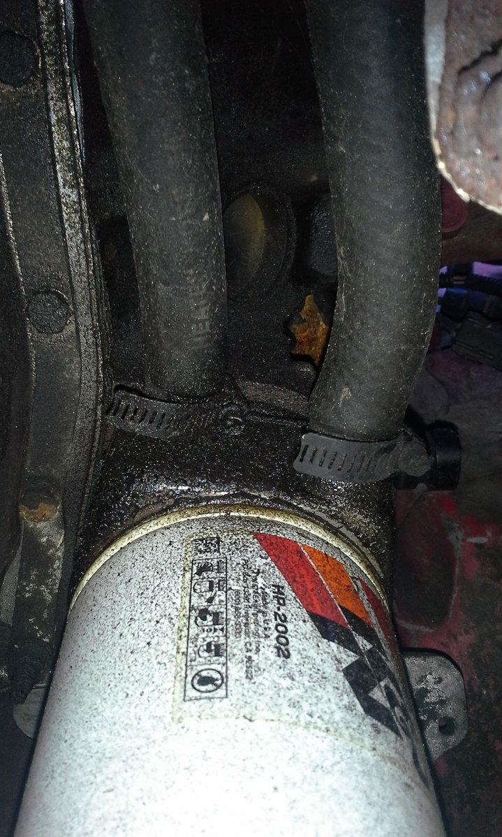

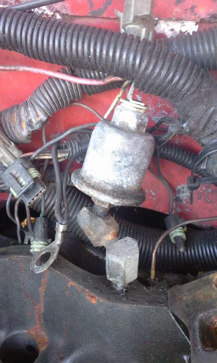

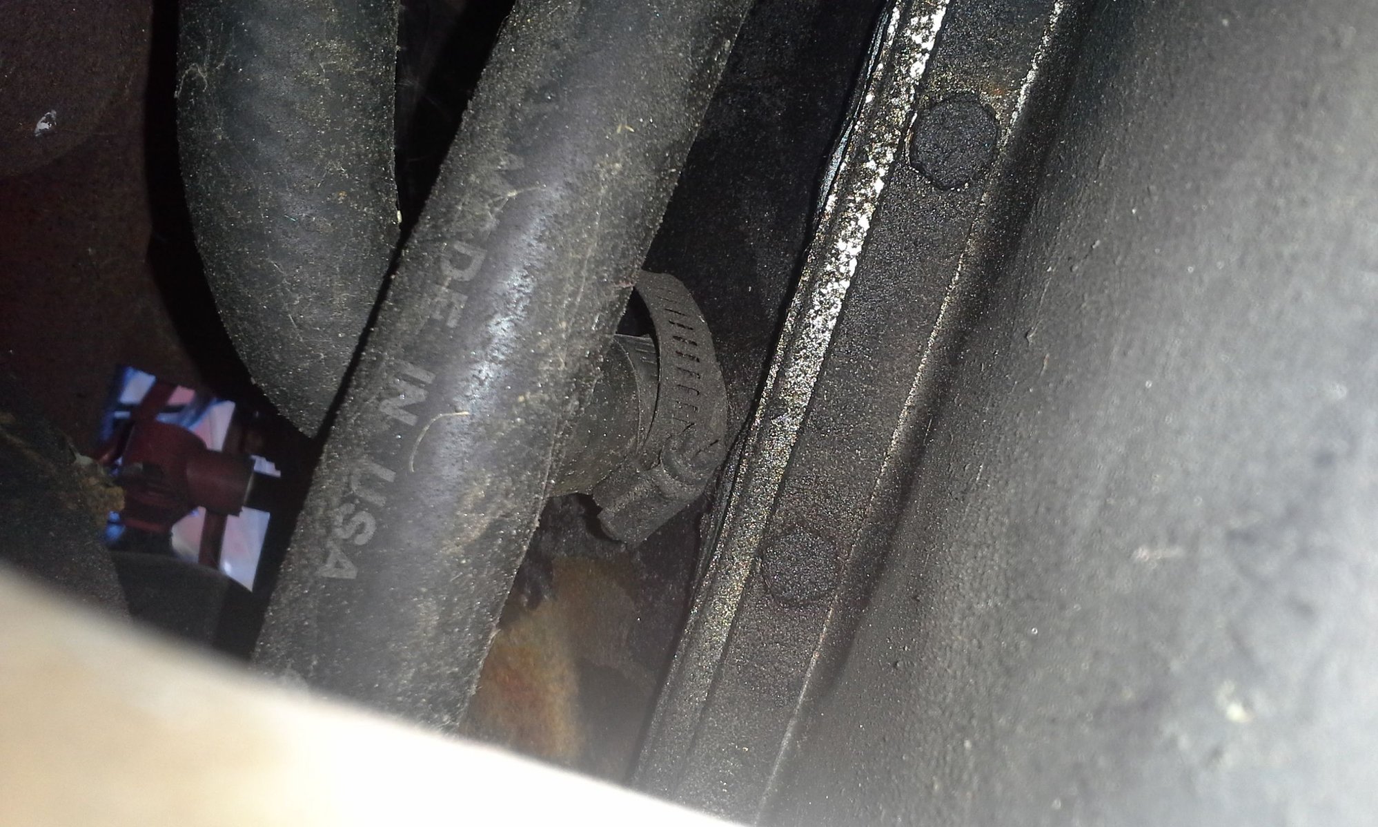

Re: Need some things figured out for new car
What is this for? I don't recall having one on my Trans Am.
I have this on the Camaro already, and I have an extra one of it as well. I was thinking it was a "sandwich plate" to allowed you to run a oil cooler or something of that sort, but it seems like the lines run to coolant?!
1st pic is a Oil Pressure Switch.
"oil cooler or something of that sort, but it seems like the lines run to coolant"
Exactly.
Oil Pressure Gauge Sending Unit.

Engine: 5.7TPI
The oil pressure switch that closes is to provide power to the fuel pump. Obviously, when the engine is not running, there is no oil pressure, so the FP relay allows the ECM to prime the fuel pump just so the engine will start initially.
They work together. (Fuel Pump/Relay and Oil Pressure Switch

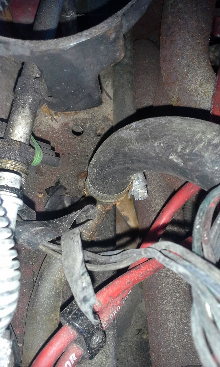

I need some help figuring out some of the wires and connectors in the engine bay.. Can anybody post good pictures of factory wiring and engine setups? There is no 9th injector, egr, or smog in the car.. From what I understand, in '87 the Camaro had all of that? What do the connectors look like that plug into those things? I just read about how you can use a '89 prom in the '87 car/computer to delete the 9th injector?
Also, would like to know how to determine which injector plug goes to which injector?

"Also, would like to know how to determine which injector plug goes to which injector?"
It doesn't matter as they are "batch fired". Left is a bank, right is a bank

Posts: 102
From: Wahxaw, NC
Car: 1989 Pontiac Firebird Trans Am
Engine: 5.0 305 V8 FI
Transmission: 700R4 Automatic

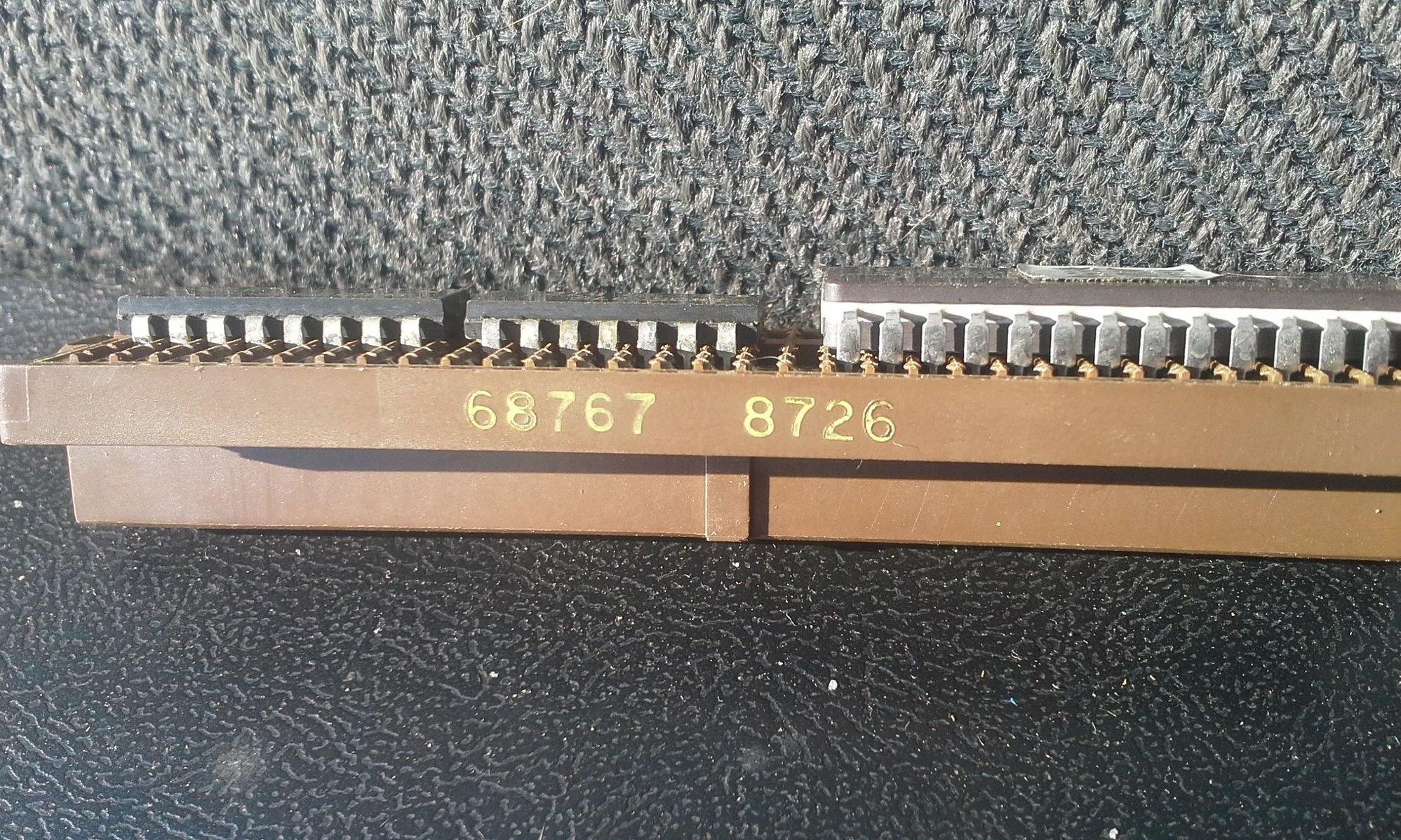

The previous owner may have already done that?...what is the bin code on the MEMCAL and service number on the ecm. Some guys have modified TBI ecm's to work with TPI.
Originally Posted by BadRiggins
Also, I have a ECU or ECC that is a remanufactured one.. "Number: 7-7165, DC Code: 0710ST, Barcode: 0771650010810044 REMFG" I was wondering what it was from and what the setting/tune would be on it?
Old Jan 13, 2016 | 09:25 AM

Old Jan 13, 2016 | 09:35 AM
  #45
R3500's Avatar
iTrader: (18)
Posts: 120
From: Champlain, NY
MEMCAL: ABWN 87 F-body automatic
From the ecm numbers posted I assume it is the proper 1227165
Also, the red arrow is pointing to the Cold Start Injector Switch on the front of the Intake. If the 9th Injector Delete was programmed out, this will not be needed. The blue arrow is pointing to the Coolant Temp switch, which IS needed. FYI
So the 9th injector is still programmed in the car, most likely? Will it run without it? I don't have any of that stuff to put it back on.
