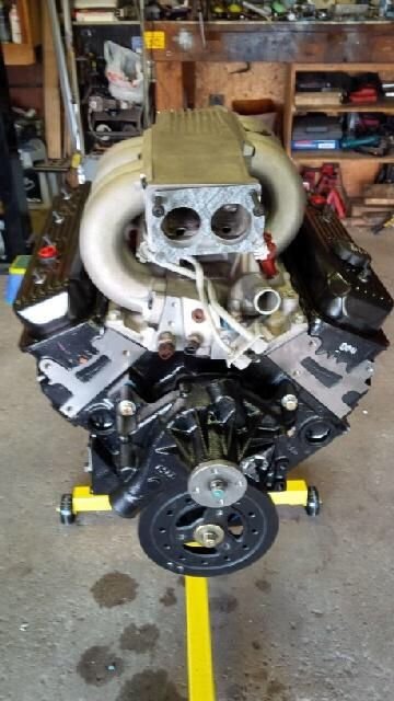

I am going to start with chip with 30# injectors. Engine is going in this week
Here it is

looks good, also probably just bad luck on our part, but we have a weep, seep, etc on our vortec sdpc base install we just did this spring on my son's formula with new ZZ5 crate engine. not terrible, but we will be taking the intake back off in a couple weeks to correct it.
we used fel pro 1255 gasket and the red rtv around the water ports, etc... we will be going to the MS98000T gasket... i did another one last year without trouble but it seems their is mixed thoughts on the 1255... don't know what you used but just fyi as you haven't installed yet

I used 1255
I hope this doesn't cause any issues
Btw gbayfischer emailed me some tunes with injector constant changed- he has the 383 with a first tpi. At least now I have a few chips to play around with to get started. Need a burner. Any suggestions auto prom is sold out til mid June ?
