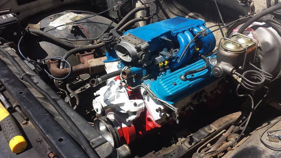

okay so I am swapping a TPI setup out of a 89 camaro donor car, don't worry my brother is using it to build he just has aftermarket ecu and harness so I snagged it. I would really like to know what all on the harness I need and what all I can get rid of, I am trying to use my 91 firebird as a template but its speed density and I haven't had to do anything with the harness so I don't really know where things go. I planned on using the chassis harness for the wipers gauges alt ect. I would assume I just need to adapt in a hot wire into the dist and ecu then one from the fuel pump relay to the pump, I do also need to completely bypass the vats setup as that was why the vehicle was parted out before I got it. I was also doing some reading and it mentioned needing a VSS and an oil pressure sending unit but didn't mention why

okay the motor is out of a 78 c10 and doesn't have a oil presser sensor or a vss and my brother kept most of the body harness which is no big deal since the body will just get power from the starter and all the truck stuff will work as normal. Okay so it looks like I will have to wait a bit to finish this up cuse I need to get a chip adapter a vss and oil pressure sensor, anyone have a part number for a vss adapter apparently it needs to be a 2000 unit per revolution right? Thanks for your input
