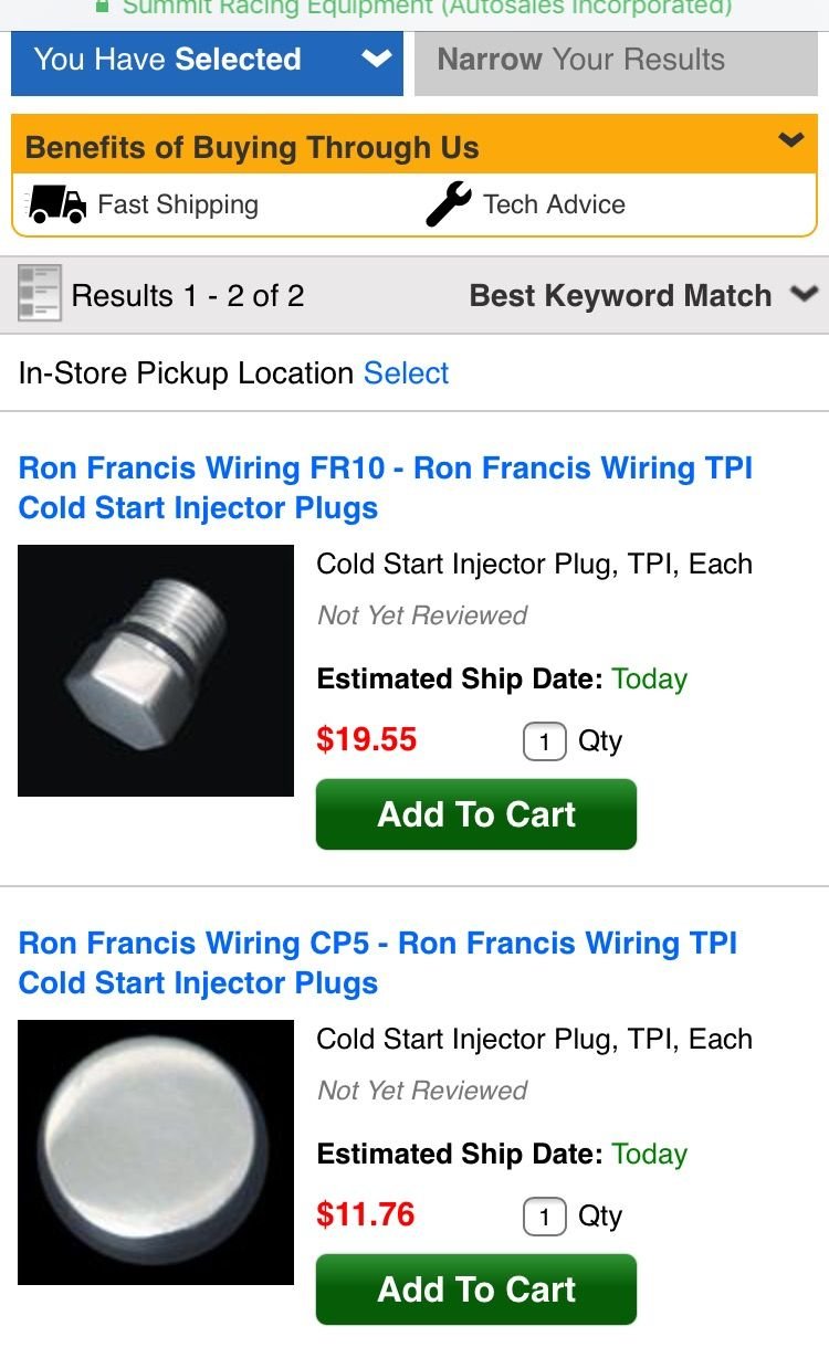

You might be able to have it serviced ultrasonic/ flow tested.
Or just block it off and go with 89 programming.
