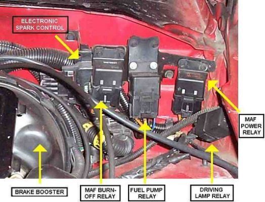

Ok,now it's started four times since then just fine. I am thinking it's a fuel pump relay issue. The auto parts store shows two different relays. An Ar255 and an ar146
Which relay does an 88 305 tpi use? Is this the relay near the battery?

The fuel pump relay is next to the master cylinder on a bracket.

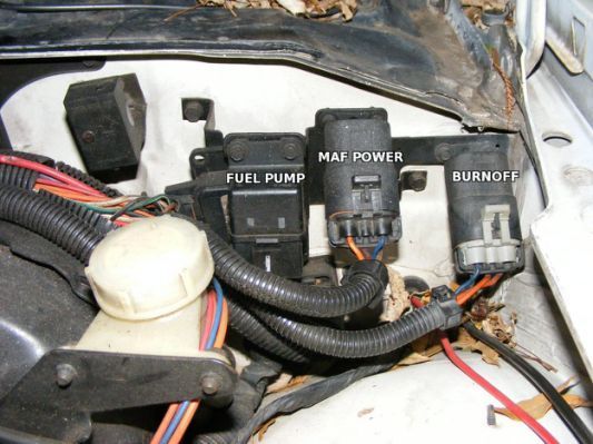

My cars relay setup doesn't look like that! Can you help me figure out which one is my pump relay or where it is?

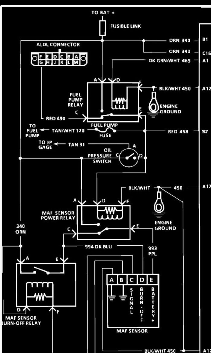

I think it might be the farthest from the fender. Grey is usually out to pump. Green/white strip from the ecm to control the relay for prime.orange power from the battery fuse next to the battery and black for ground.

Thanks again "Tuned Performance" for once again helping me out. So it's the furthest one from the fender then. I am curious,in the photo you posted of the white car that has a similar really set up to mine, what is that white ****? My car does not have that

AIRTEX/WELLS 1R1240, the white **** in the picture is the clutch master cylinder reservoir.

You might want to see if the ecm is supplying the relay power for the 2 second prime on the green/white stripe wire. If it is than its either the power to the relay, ground or out to pump wire.the schematic above should be accurate.
