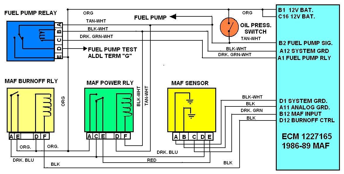

If the rain holds off today ill check edu after work . I did find some sketchy looking wires on the mad burn off relay and a corroded wire ill fix and update tonight

If the relay terminals are melted due to heat or a high amp draw you might want to use the 89 up relay.
https://www.thirdgen.org/forums/elec...ump-relay.html
