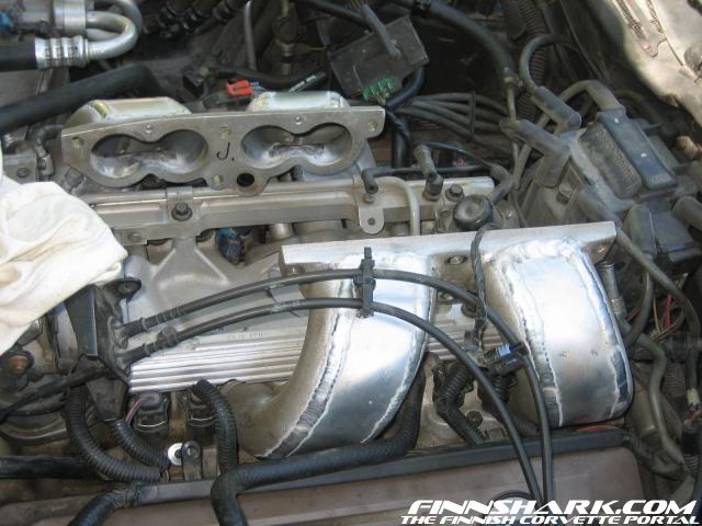

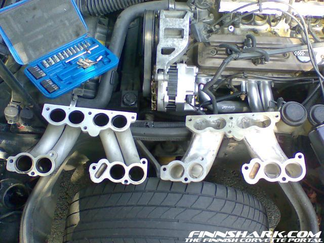

well I have ordered my parts and started tearing down the engine for removal. hopefully I will have everything to install on the block over the Christmas break.
I am planning to port the existing base and plenum as I have seen many posts having good success doing this.
But replacing the stock Runners would be the best way to go but what about siamesing the stock runners is this a viable option?
I have access to a shop and all the equipment needed to cut and weld as needed. I have seen posts about doing this but not much is talked about how well it performed after the fact so if I can not find High-Flo runners would this option work? in the short term till larger runners can be sourced

My question/concern with siamesing the stock runners would be even if you cut and weld them together, how much actual cross sectional area have you picked up? -and won't the ports, in and out of the runners still be the same factory size? Not looking at 'em right this second, so it may be feasible. I just don't know.

Abubcac thanks for the insight I have ordered the XFI 268 so yes I may at some point go with a HSR. the supplier recommended studs and I went with the APR's.
I will be sticking with the stock bottom end for now but the option of a 383 is quite intriguing. I will not be finishing every thing off till winter is over here in northern Canada so that gives me 6 months so you never know what may happen is I have the cash.
The challenge of siamesing and porting the intake system is something I would like to take on and if I am not happy with the results I see a HSR in the next year or so but if I like it all the better.
I would be doing something like the attached photos of what was done by a person on the corvette forums. https://www.corvetteforum.com/forums...unner-mod.html
the ports would be enlarged and the tubes would need to be welded on the outside and partially siemesed.
