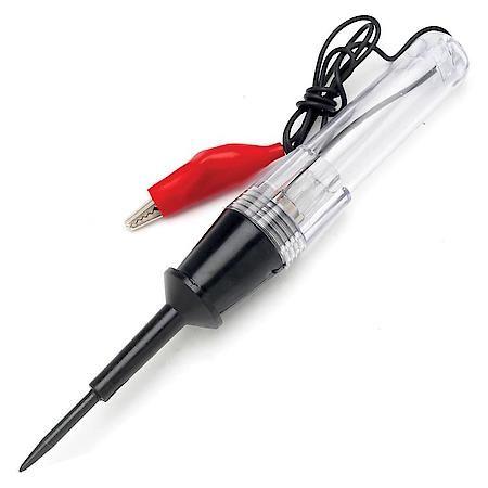

What is a test light? (In the chart for Code 21)

Your right ac is air conditioning.
This is a test light

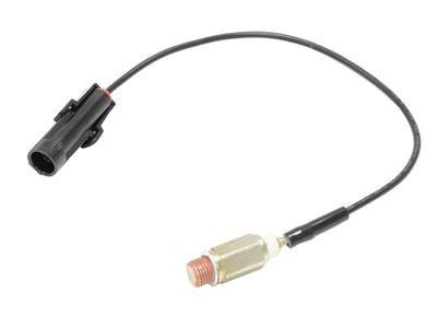

I found Out one thing that might be a problem.
I have an EGR Valve installed (I Heared some people remove it). I replaced Mine some time ago to try to fix my Error Code 32-Issue.
I recently found out that there should be an EGR Temp Sensor Attached to it...but there is None iny Car...the sensor is Missing and the Wire Just goes to ground (attached to the cars Chassis).
Is there any way to get the Sensor? I looked at Corvette Central but they Have a lead time of at least 3 Weeks (spoke to them via Mail)...Or has someone the Sensor and ist willing to sell IT?

https://www.ebay.com/itm/EGR-Tempera...-/263099168515

Thanks,
somehow my eBay did Not Show that.
Is it possible that this Missing Sensor causes Error Code 32?
Greets
Max

Can I use this sensor AS Well:
https://rover.ebay.com/rover/0/0/0?mpre=https%3A%2F%2Fwww.ebay.com%2Fulk%2Fitm%2F202316716379
The Shipping costs are much more reasonable on this one (:
