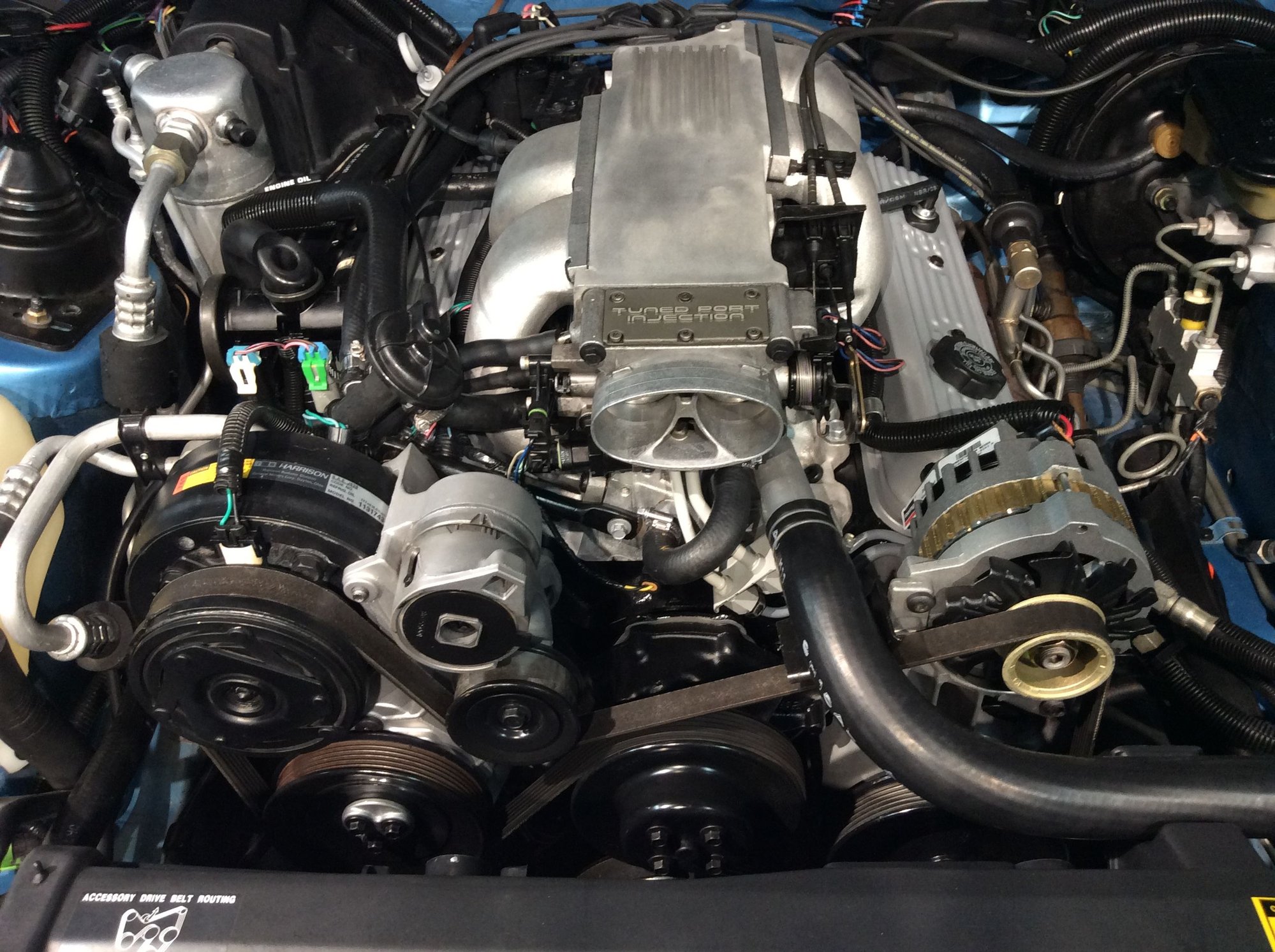

A few weeks or so out on actually trying to start the engine with these. Started re-assembly of MPFI fuel rails last night and realized the kit I purchased is missing an o-ring. Need to look on the box which is not here, but I think it was the fuel pressure regulator kit. The missing o-ring is for part #250, the connector, base to fuel rail. The short connector that goes into the base of the fuel press reg. I guess they don't expect you to remove this part from the base, only the fuel rail. huh? it needs 2 o-rings, not 1.
Upon this set-back thought I'd look up the Delphi Part number of the injector. Don't need this to be the next issue. Can't find it. What gives? Nothing for a 305/LB9

hoping to fire up the bird later today. fingers crossed, or I'm gonna be scrambling for data logging equipment and learning how to use it.

Bird fired right up! Running strong. Haven't timed it yet, just set dizzy based on #1 at TDC. Ran out of time today, will get more done Thursday. No way of knowing for certain with out logging some data, but injectors seem to be a direct drop in!

update. timed it today. to spec. seems to run better with at 10 BDC than 6. anyway, seems to hesitate upon hitting accelerator. hard to be sure. i have throttle body open and may be confusing air sucking with hesitation. i had separated throttle body off to clean it up a bit and damaged gasket, so that could be it. plan is to rebuild it but could wait to find out if she would start. have not road tested. this is all while in park.

Soooo nice to see a good clean factory looking engine in these..

took her for a short, full throttle spin today while terrorizing the neighborhood. runs like a LB9. these injectors are fantastic!
