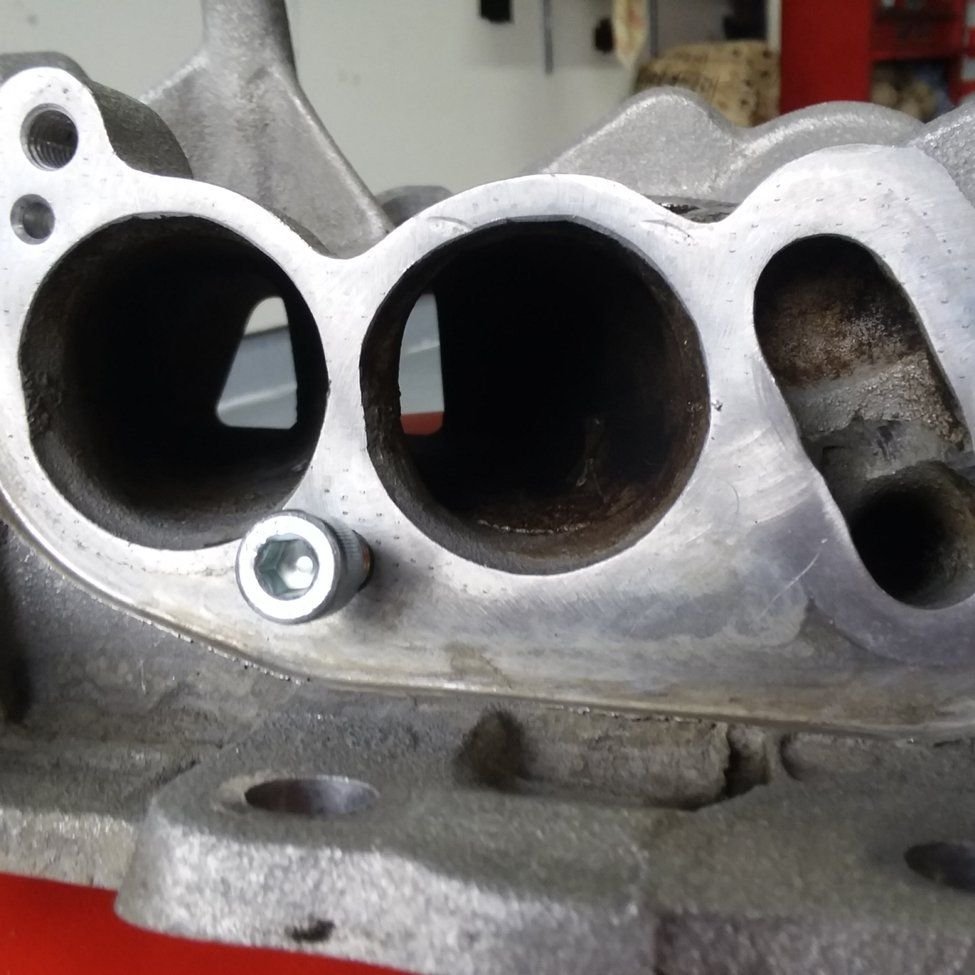

I just finished a build with oversize runners, AS&M large tubes, not Siamese. I did port my base and plenum. That 1.48 opening after the runner pulse will do nothing but hurt you. At that point in the system you want flow. I also feel the plenum needs to be open to the 1.62 also. This may not be as critical as the base but I feel it is. The "venturi" is in your TB so after that the logic is get as much air in as smoothly and quickly as possible for max HP. My speed density system seems to be doing a good job after the influx of more air. I have not datalogged but I did a plug test and they looked good, if anything maybe a little lean. If I drive like I did before the mods I think the mileage remained the same. It is on the decrease the more you increase the throttle but the HP increase you feel so this is normal. On the highway I think the MPG is the same, maybe 1 or 2 MPH better? I have not driven alot on the freeway. The biggest difference I see is my RPM's have dropped @ cruising speed. I used to run about 3k to do 80mph on my speedo. Now it is about 2700-2800 to maintain the same speed.This is consistent at other MPH's. So I will assume that I will get a mileage increase when just cruising.
Doing the complete package is the only way to go IMHO, the runners are just a piece of the restrictive puzzle that is TPI and unless you address it all It is like you a robbing Peter but not paying Paul.

Vinny R, you did some good work on the porting and I'm sure there's a noticeable increase in power and throttle response. That said, RPM to MPH is what it is. There's only a few ways you could drop RPM and be going the same MPH, like a gear or tire change. The only other thing I can think of is going from a bad/slippiing stall to a properly functioning one, or a high stall converter to a more efficient low rpm stall. If no other changes, then maybe you're lock up function on the stall converter wasn't functioning properly before and is now (after the mods)?
Regarding the OP, there's not much benefit going with the SLP runners unless you open up the siamesed area, match up and port the plenum, and at the lease take out the lip/bump at the runner to base point, Vinny R took a really good shot showing the lip/bump right at the runner entry point (below). His link to the work he did should be very helpful.
So, IMHO, unless you're willing to do the work to the SLP runner, plenum, and base, you're probably better off with just sticking with the stock runners.
