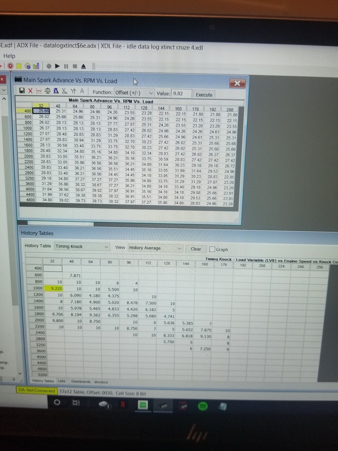

Any ideas or maybe i can Barrow a bin to compare? My blm is looking good, it shows that im getting knock but no KR. She doesnt die on me just hunts idle sometimes, and other times literally idles silk smooth and sometimes lightly shakes.

Here is a pic of the knock its detecting but its not taking any timing out...
And thats is what my timing table looks like....

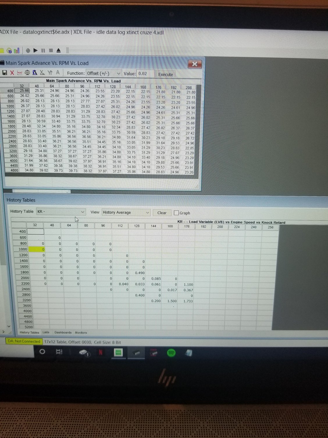

This is the kr its actually pulling,
Now i was told that with this cam 6* for base timing is what i would want.

Re: 383 stroker with xm276hr HELP
6 degrees base is fine, as long as it matches what's in your bin. Around 20 degrees of timing at idle would be a good starting point, you can add or subtract from there to get it fine tuned to fit your needs. For the knock, pull some timing out, maybe 4 degrees or so, data log, if its still showing knock counts, I would consider it false knock and keep that in mind as you ramp timing back in. I missed what head you have, the more efficient the combustion chamber you have, the less timing you'll want in it, especially through peak torque to avoid detonation. Is your idle screw maxed out to add or take away idle speed? And what is your iac counts at hot idle? You can always bend the tab that contacts the idle stop screw instead of turning the screw if needed. You want your iac counts low, I'd aim for 20 or less,at hot idle, but it can be a balancing act between opening the blade, and adjusting the tps (to around .5 volt at idle), until you achieve your desired idle speed and iac count. And I prefer for cars with cams to idle higher. On my 276 cammed engine with an auto, I had idle set to 800 or 850.
