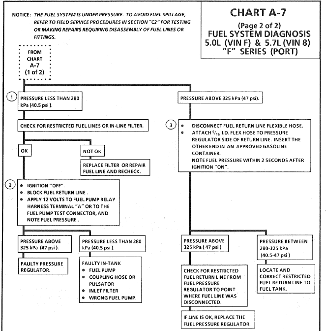

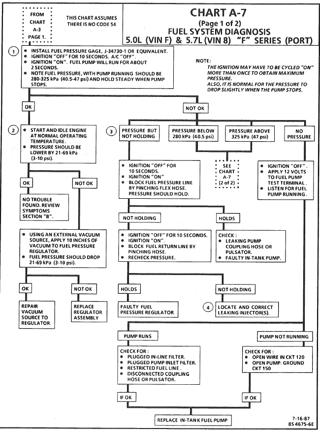

I got my hands on service manual which have troubleshooting charts. I blocked return and still got 35 PSI. I unblock it and put it in generic gas canister. No fuel in return line and pressure still 35 PSI. Another thing manual says that pressure should hold after pump shut down. Mine goes straight to zero. All that means I have to drop axle and tank. One thing i can not check is to pressureize whole system and pinch main line to see if system holds pressure. I changed all rubber lines with stainless steel braided lines and pressfitted fittings.
With troubleshooting, regulator seems to be okey. Pump i put there is Performance Electric P240KC from Rokcauto. Problem might be in that cheap pump or with in tank connections.

What i used is service manual troubleshooting:

Hi, my old thread but if anybody is thinking which pump to buy. Some of them might have quality issues. Replaced Performance Electric P240KC with Delphi FE0110 pump. Pressure is now good and whole system passes service manual troubleshooting perfectly.
