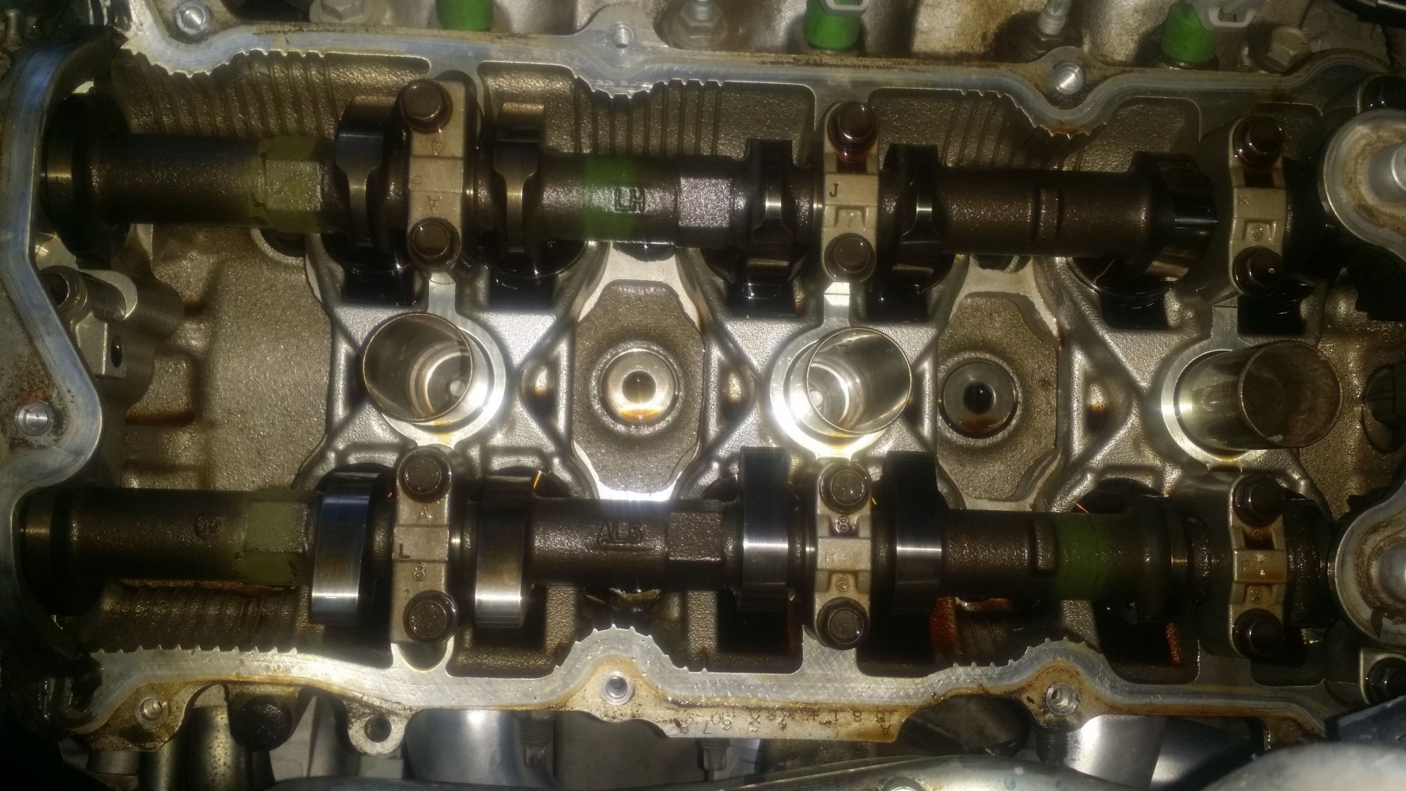

At 215K my rubber valve cover gaskets on my 07 G35 where as hard as a brick. They were seeping oil onto the exhaust. I got the car with 130K on it and switched to synthetic at that time. I run Mobil One or Penzoil Platinum with a longer oil filter for a Titan and change it every ~7,500 miles. I also run a bottle of Techron in the fuel before every oil change. I think the results speak for themself.

That doesn't look like 200,000 miles worth of sludge. That's a testament to good quality, clean oil with good flow thanks to the designers and your driving habits. The oil clenliness is helped by a good filter, but may be more attributable to good fuel control since combustion deposits are frequently what contaminates oil. It also appears that the engine gets up to full running temperature and sustains it for long periods, which helps oil flow and its ability to clean.
The real test of the oil is how much wear occurs in that 50-60 feet of timing chain on the front of the Nissan. I'm guesing that you haven't had too much trouble with that yet, judging by the general condition shown.

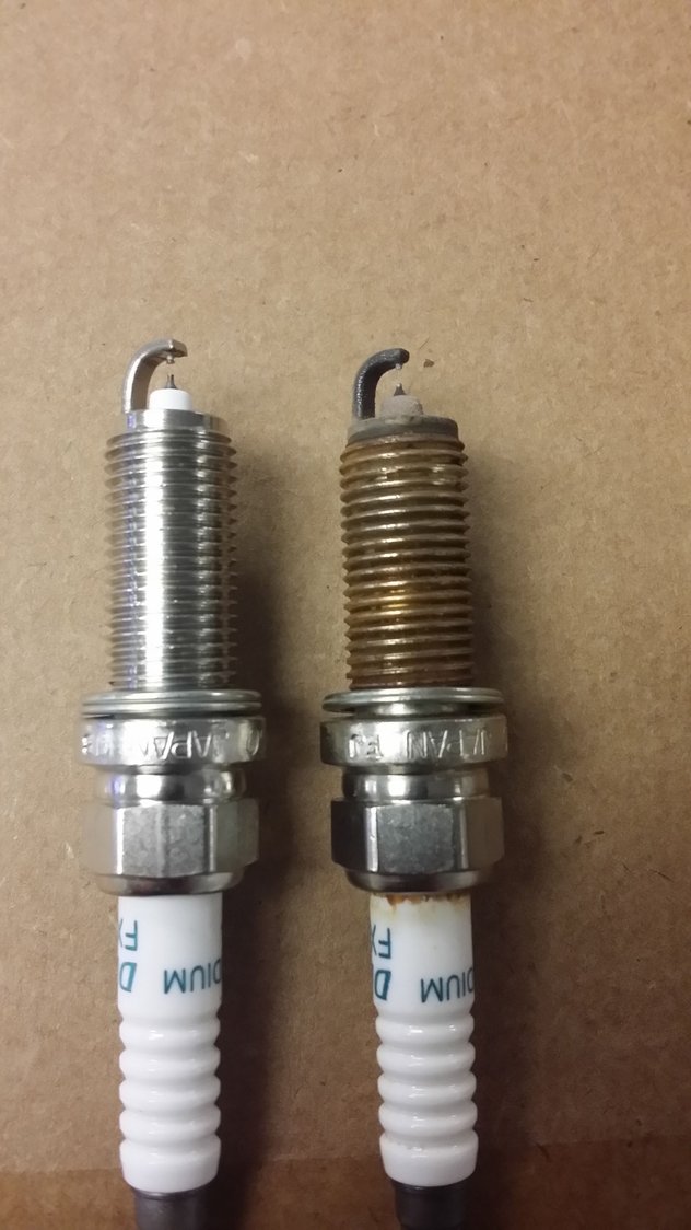

They do it b/c it's a religion. It would look like that without the bottle of snake oil. :yesnod:
HAVE A LOOK HERE
Actually they didn't look like that when I did the plugs. They had carbon buildup and were in general fairly sooty and nasty. Remember VVT engines use cam phasing for internal EGR. Not nearly as bad as my other Infiniti but not clean like that either.

This is a weird, but typical post process for Fast355. Maybe I've missed something;
Originally Posted by Fast355
At 215K my rubber valve cover gaskets on my 07 G35 where as hard as a brick. I got the car with 130K on it.... I also run a bottle of Techron in the fuel before every oil change. I think the results speak for themself.(sic)
(See pics in post 9 of the cams/head and another if the intake runner)
What's Techron use got to do with the cleanliness of the head/cams? (photo #1). That pic is ALL about decent oil and doing oil changes...not Techron.
Car did not even get plugs changed in it until 177K.
Wait...say what!? First, what didn't look like what "when you changed the plugs"? What does changing the plugs have to do with anything in this thread? Were you talking about the intake valves? Is that what "had carbon build up and were in general fairly sooty and nasty."? Because did you see the intake valves in the pics that I posted of intake valves that never saw Techron?
When did you start your your Techron regimen? When you bought the car and "switched over to synthetic"? Did you run it 47k miles, then change spark plugs, somehow look at the valves, and then in the next 38k, they cleaned themselves up? The Techron worked after 177k...but not so much, before? Did the Techron, after 177k clean the intake valves to about the same cleanliness as the pics I shared of nothing-special-gas, no-additives, engines? Please elaborate with a clearer timeline! This is quite an interesting tale, so far.....
