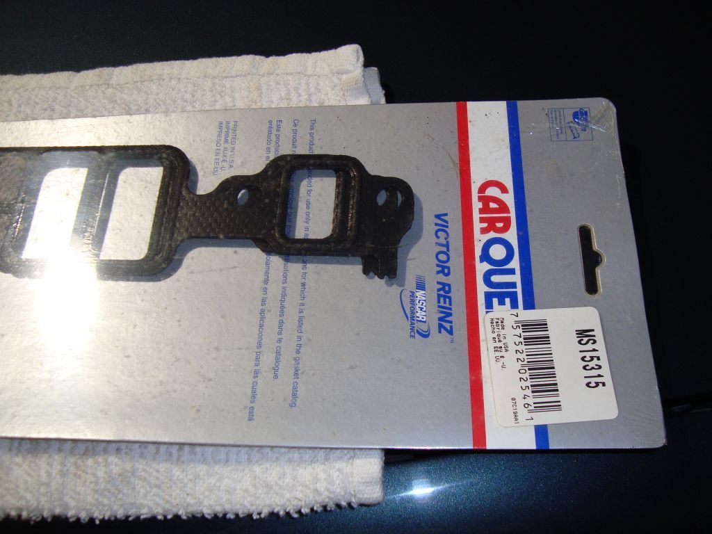

This was some time ago as Car Quest was absorbed by Auto Zone (or Advanced?). These are your basic stock replacement gaskets (port size wise):
RBob.

I'm in the process of installing an Edelbrock intake. Would those fit the ports?

The ports on that gasket measure about 1.25" X 2.0"
RBob.

I found those gaskets on Autozone's website as well as eBay, but for some reason both of them say that they won't fit my car. Any ideas why, or is their information wrong? Sorry for badgering you on this topic. I just want to make sure I get the correct ones.

Because Vortec heads have the mounting holes in a different location?
Or, stock '92 SBC heads have the four inner bolt holes in a different location?
RBob.

These are for my '92 T/A with stock heads, not the '91 GTA that has the vortec heads. Sorry for the confusion.
